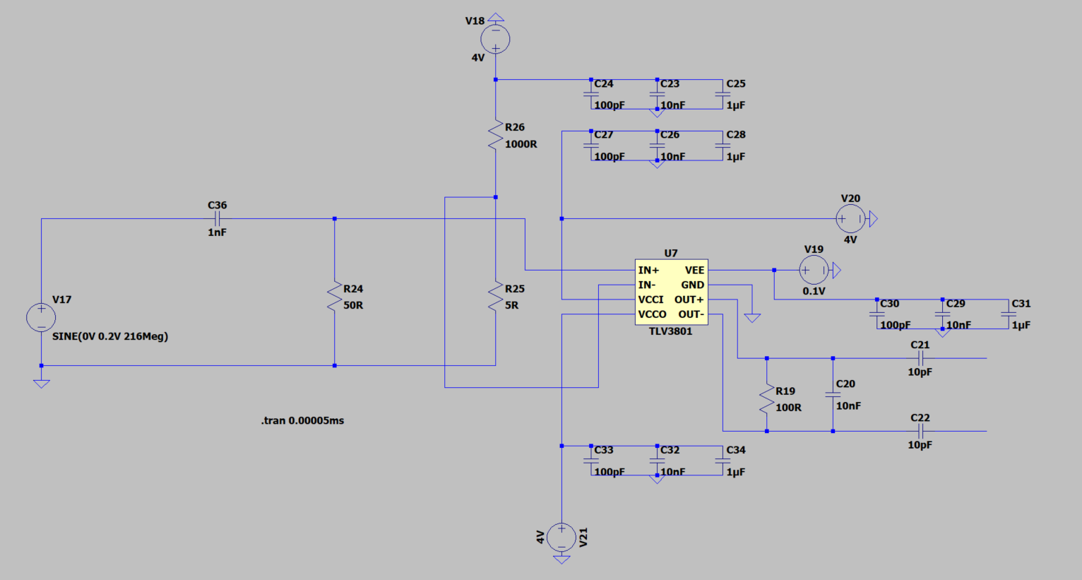

Hello everyone,

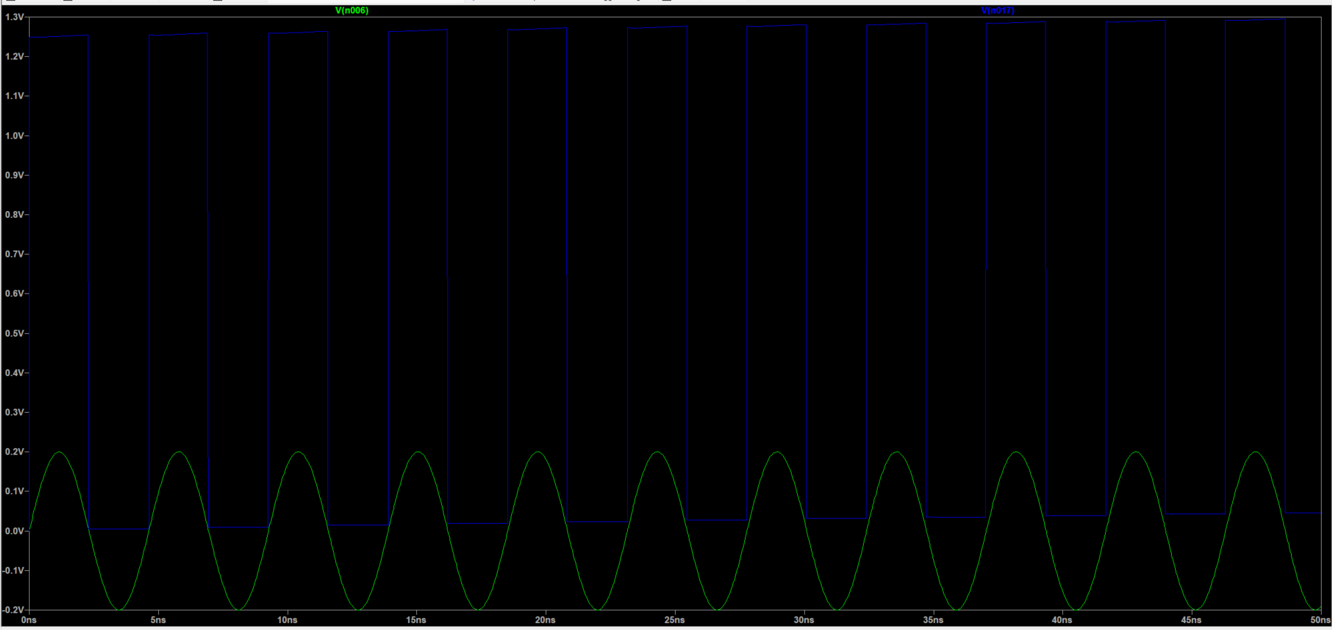

I am currently trying to develop a circuit that uses a TLV3801. To simulate the components I am using LTSpice. The basic idea is to feed the non-inverting input of the TLV3801 with a high frequency (216 MHz), low amplitude (200mV) sine wave so that a 216 MHz square wave gets generated on the output.
So far the accomplished results look very promising. I've added a few screenshots to show you the obtained signals:
The green signal is the 216 MHz sine wave and the blue signal is the out+ pin of the TLV3801. So far so good. Now the problem is that in the next stage I need to feed that square wave into a d type flipflop (SN74AUC74) which operates at around 1.8 V VCC. Hence the flipflop's high-level input voltage is roughly 1.2 V which fits perfectly. But the low-level input voltage is about 0.6 V according to their data sheet. So the above square wave could not be used like this because it would actually never turn off the SN74AUC74.
So I was experimenting a little bit and somehow got the perfectly shaped square signal for my specific application by slightly modifying the above circuit. See the screenshots below:
Now comes the actual question - Can the VEE value of a TLV3801 be slightly higher than GND? When I put VEE around +100 mV the circuit seems to work pefectly fine (see the above blue signal). There is a little drift causing the lower value on the out+ pin to slowly increase from 0 V up to a maximum of about 120 mV but still that signal would be perfectly fine for my use case. If I set VEE to -100 mV, -50 mV or even +50mV or +200 mV there is no signal on the out+ pin. So +100 mV seems to be the sweet spot. Is this just a numerical issue / not a realistic result? Or would it actually be technically possible to set VEE to 100 mV even though if it is expressly not recommended because it exceeds the maximum ratings of the IC?

  • Hello Laule,
    VCC and VEE establish the supply operating range for the device (and the input voltage range). VEE must be the most negative.
    The GND pin sets the output ground reference for the LVDS output (output VOCM = GND + 1.25V)
    VCC and GND must be within VCC and VEE - so GND cannot go lower than VEE.
    So if you need to shift GND down -100mV, then shift BOTH VEE and GND together.
    Why do you have a 10nF across the output? Is this cable capacitance? At these frequencies - the cable capacitance should be part of the trace/cable impedance. Normally additional capacitance on the output is avoided.
  • Hello Paul,
    thank you for your reply. In my original post VEE was +100mV above ground and that is why in your reply you said that GND cannot go lower than VEE. So out of pure curiosity I've set VEE to 100mV and GND to 200mV so that GND will now be 100mV higher than VEE (like in the image below)
    The resulting signals look like those below (I've removed the capacitors on the output to show you what happens without them)
    Without the 10nF capacitor the output signal now has little "overshoot-like" artifacts that oscillate between the output common mode voltage's lower and upper threshold (between roughly 1.1 and 1.4 Volts). Nevertheless apart from these oscillations that get smoothed away using a parallel capacitor, the resulting blue output signal looks immaculate. The edges are very sharp and the range between 0 and 1.4 Volts would be perfect for processing it further in my circuit.
    So my question: can the above simulation's results be trusted? Can the VEE value of a TLV3801 be slightly higher than 0V even though if it is expressly not recommended because it exceeds the maximum ratings of the IC?
