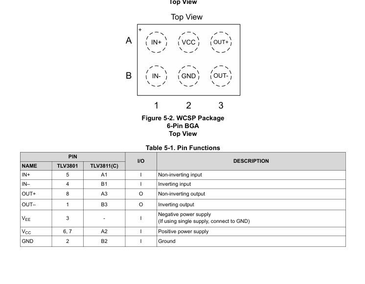

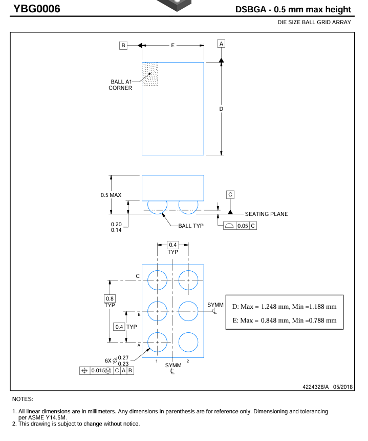

Please review the pinout discrepancy on page 3 of the datasheet for this device. The pin numbering is not consistent with the YBG package shown on page 27 of the datasheet.

Hello Mason,
Please see this post:
Please use this updated pinout below:
I'll check to see the status of the dataheet update.
