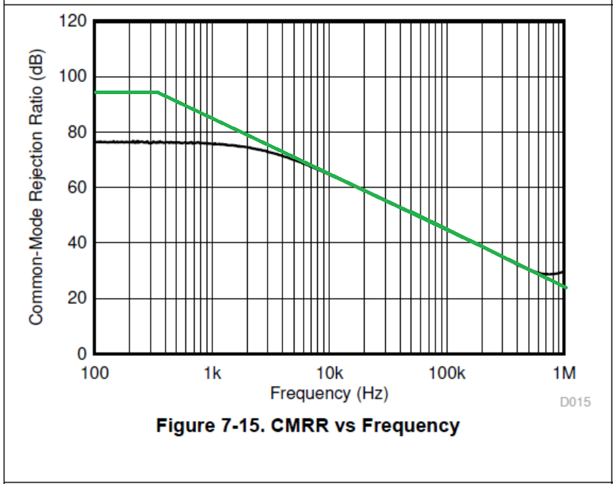

Have a nice day! I have questions about TLV9001-Q1’s PSRR and CMRR:
Why these two features decrease with the increasing of frequency?

Hello Leo,
PSRR and CMRR drop in frequency because the op amp open loop gain also drops with higher frequency.
Also 7-15 doesn't look right. CMRR vs frequency test requires (near) perfect external components and should compensate for actual forward gain. Neither was done fully.
This is a more realistic CMRR curve. However the knee would be curved.

Where does this picture from? Which device? And what the black and green curve mean?

Leo,
The picture came from your first post.
I made the green curve from the 95dB value in the TLV9001-Q1 data sheet.
