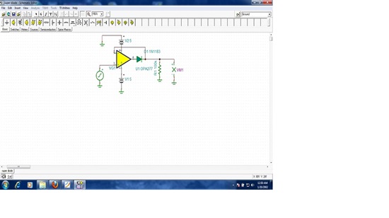

1. I am trying to make precision diode(super diode) using op-amp opa277. the problem is that when I am increasing value of output resistor from 1k to 10k, voltage spikes to negative side are increasing(I mean one voltage peaks in each cycle  of short duration is appearing during simulation in TINA-TI).What is the reason of appearing voltage spikes?

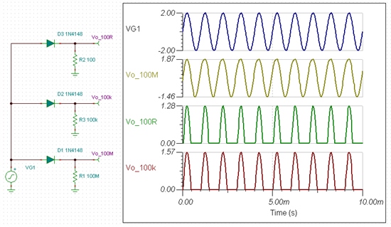

2. if I increase the value of resistence 10M the output is coing same as input (rectifier action of super has gone now). What is the reason behind this phenomenon?
3. If I want to interface the output of this super diode with microcontroller msp430  (having very hign input impedence) would this suoer diode work?
