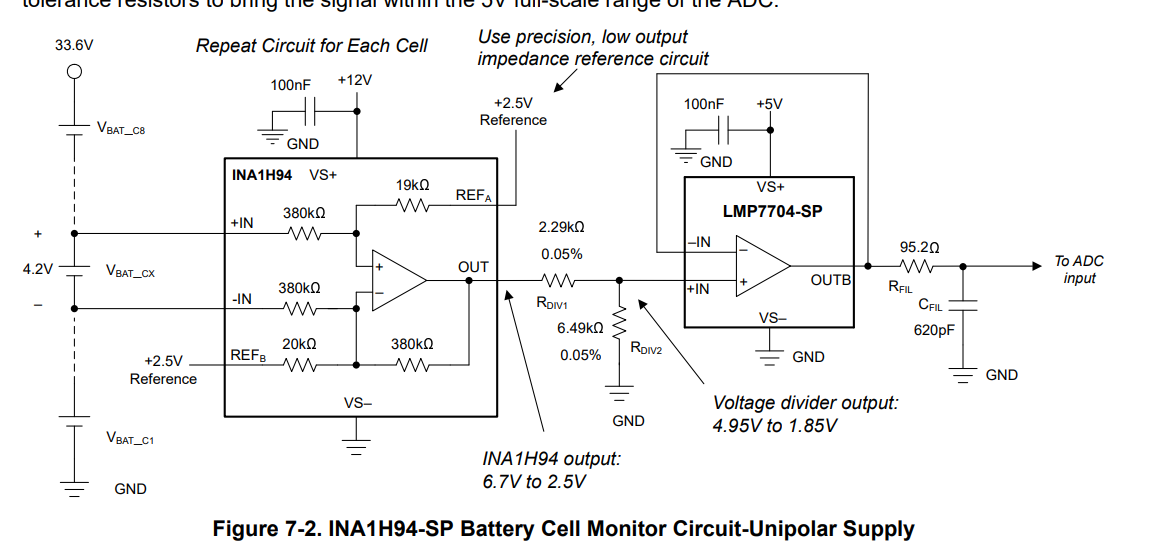

INA1H94-SP: Avoid back-feeding/back-powering when VCC is off
Part Number: INA1H94-SP
I'm using the op amp in a the same application as shown in figure 7-2 in the datasheet. One of the requirements of the battery is a disabled state where all on the on-board electronics are off to lower current draw and lengthens the storage duration. This results in back-feeding on the VCC and REF pins. What's TI's recommendation on avoiding this with a live input with VCC/REF off?
