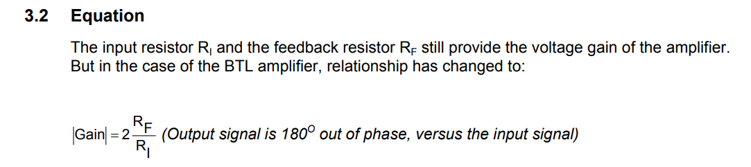

I want to use Calculating Gain for Audio Amplifiers (Rev. A)  to calucalte gain for TPA6211A1 BTL amplifier. But in this guide the gain fromula is given 2*Rf/Ri

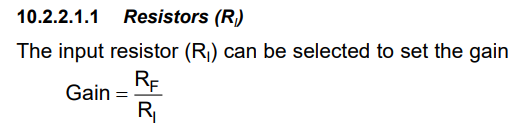

In the datasheet of TPA6211A1 gain is given like:
what formula shall be used to calcualte gain when using TPA6211A1 in SE input configuration?

    Please use the formula from the TPA6211A1 data sheet to calculate the gain. This is Gain = Rf / Ri being Rf = 40k.
    Note TPA6211A1 is a fully differential amplifier, not a BTL driving amplifier.
