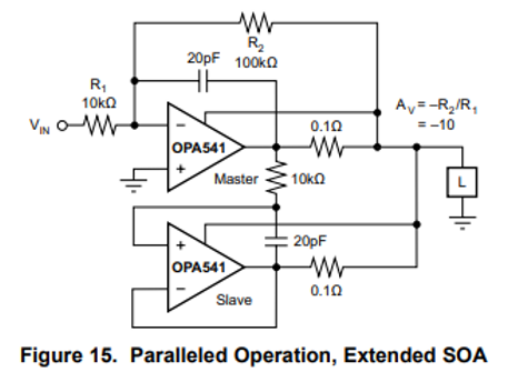

Part Number: OPA541
Customer would like to design as below configuration.
operating condition is +/-25V, 15A and gain is 4~5.
Please recommend proper resistor value instead of 0.1Ohm
Thanks.

Hey David,
Happy Holidays!
.1ohm is traditionally a bit on the lower side for ballast resistors, though it is certainly a functional size for running parallel amplifiers like this. When we have a relatively low value ballast resistor like this, layout becomes even more important, especially in ensuring that the output traces are run in a symmetrical manner.
What makes you ask for a value other than .1Ohm? I have seen customers successfully implement with low value resistors like this before. As mentioned before, the lower value does add the requirement for more care, though there is often little choice in sizing the ballast to be much larger when we are talking about many amps of current flowing through.
Here is a nice app note on the topic of paralleling power amps together: Paralleling the OPA593 High-Voltage, High-Current Op Amp for 2 × Output Current
Can you tell me a bit about this application?
