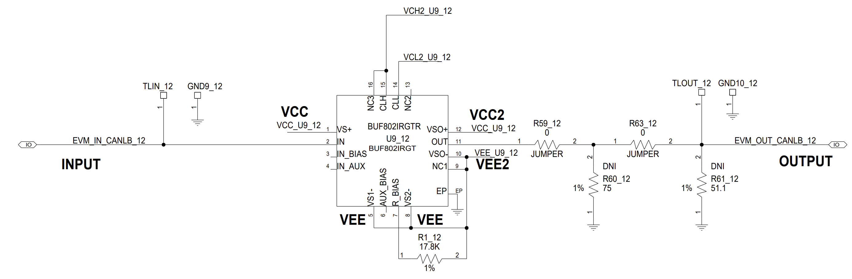

Part Number: BUF802
I am using the Buffer in BF Mode.Below are the results offset that i am seeing
Can you please help me understand where this offset can come because as per datasheet Vout<Vin-0.6.

Hello Lalit,
We are looking into this. Please check the input voltage should be mid point of the supply with allowed variation of +/- 1V.
Jyothi
