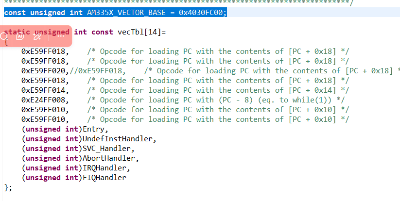

I'm using AM3352 to work on a project.      window + CCS +stareware
now  I need to implement certain functions through SVC.
   The problem is that after entering the SVC, the corresponding code was not executed and the SVC was exited directly.
  • Generate SVC through the following statement
          #define portYIELD() __asm volatile ( " SWI #0" );
  • SVC_Handler is implemented in the.asm file.     exceptionhandler.asm
  •   startup.c file  is following picture
