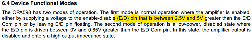

On the EC table, high threshold for E/D voltage is E/D om +1.5V (min).
However, on 6.4 Device Functional Modes, it is stated high threshold is E/D com +2.5 (min).
Which statement is true?
Kei Kuwahara
  • Hello Kei,
    My apologies for this inconsistency in the datasheet. The EC table is correct, the valid enable range is between 1.5V and 5.5V above E/D Com. The SHDN mode would be active from E/D Com to E/D Com +.5V.
    We will work to update section 6.4 to correlate with the EC table.
    Please let me know if I can offer any additional help with the OPA598 amplifier.
    Jacob
