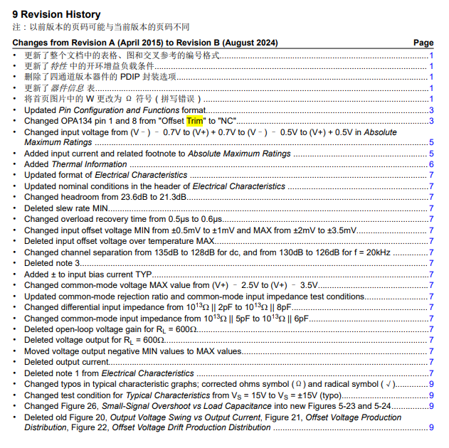

Hi ti team,
  • The OPA134 IC has undergone major PCN changes from Revision A (April 2015) to Revision B (August 2024). Our customer is currently using this IC across multiple distinct projects, so could you please provide a comparison table of the differences between Revision A and Revision B?
  • Could you confirm whether the revised OPA134 Revision B is fully pin-to-pin and functionally compatible with Revision A?
  • Do the differences between Revision B and Revision A have any impact on the functional testing (procedures/results)?
