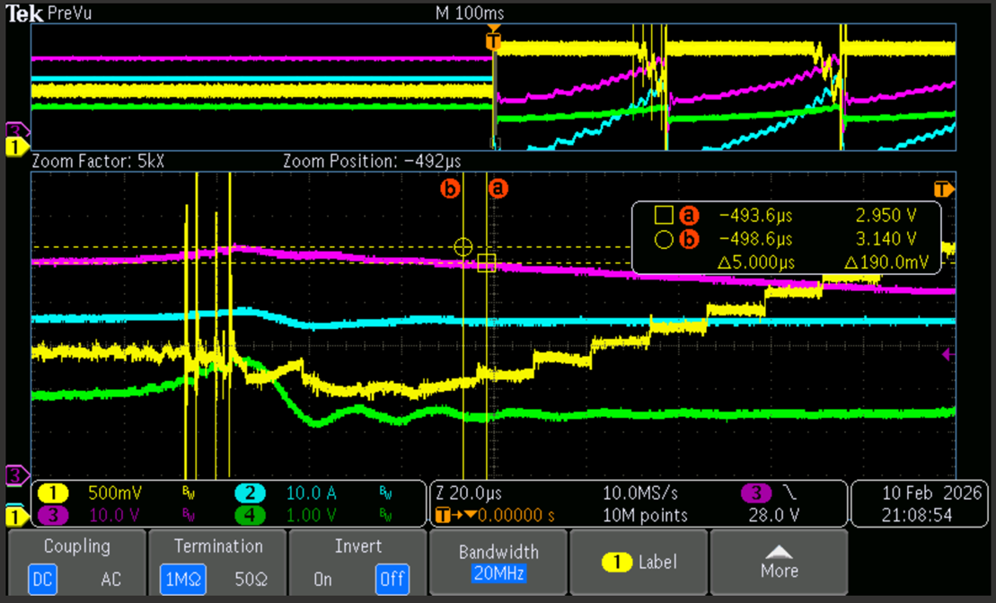

Hi team,
The customer encountered an issue during the burn-in test.
Test conditions:
Ambient temperature: 45°C
Input: 300 Vac / 50 Hz
Output: 48 V / 90 A
After approximately 30 minutes of burn-in, high-frequency noise was observed on the OPA output. This noise interferes with the control loop and causes a momentary increase in output power, which then triggers OCP protection.
The issue typically occurs after nearly 30 minutes of burn-in, at which point the IC temperature may rise above 90°C. We have also confirmed that the IC Vcc voltage remains stable at 3.3 V during the event.
From the waveform, it appears that a sudden rise in the OPA output may be causing the control malfunction. Since this phenomenon only occurs at high temperature, we suspect that the OPA may be entering thermal protection due to overheating.
We would like to ask:
1. What could possibly cause this type of waveform behavior?
2. For this condition, are there any recommended thermal improvement solutions? (ex: are there any internal thermal pin for this device?)
Waveform channels:
Ch1: DAC (represents Vout feedback = OPA output)
Ch2: Iout
Ch3: Vout
Ch4: Iout feedback (OPA output)
Thank you.
  • Hi Jenny,
    It is difficult to determine the root cause with the information provided. Based on the burn-in conditions described, one possibility is that the device's thermal protection may be activating, particularly if there are significant output current demands on the TLV9154.
    Are you able to share additional information such as:
    • Schematic
    • What is the output current that is being demanded from the TLV9154
    • What is the supply condition of the TLV9154
    • Any other relevant details would be appreciated.
    Note that the device has thermal protection and if it is indeed kicking in, you may see unexpected behavior. When thermal protection engages, the output stage can momentarily disable. This loss of drive may appear as unexpected transitions in a control loop system. See the excerpt from the datasheet below.

  • Hi Jenny,

  • Hi Jenny,
    I have done a thorough stability analysis. What I found is that the input resistors are very high and interacting with the beta network and the input capacitance such that a zero occurs in 1/beta. This causes the phase margin to be 27.71 degrees which is unstable. Because this is an interaction with the beta network and the input capacitance, changing the feedback capacitor has little affect.
    I found that you have two options
    1. Reduce all the resistors by a factor of 10
    2. Or add a capacitor across RB72 that is the same value as the feedback capacitor.
    My second simulation below shows option 2. Notice that my phase margin is now 44.77degrees which is an improvement from the original circuit that has 27.71 degrees. For this reason I believe there is a stability issue that is contributing to the problem. I have attached my Tina simulation below as well.
