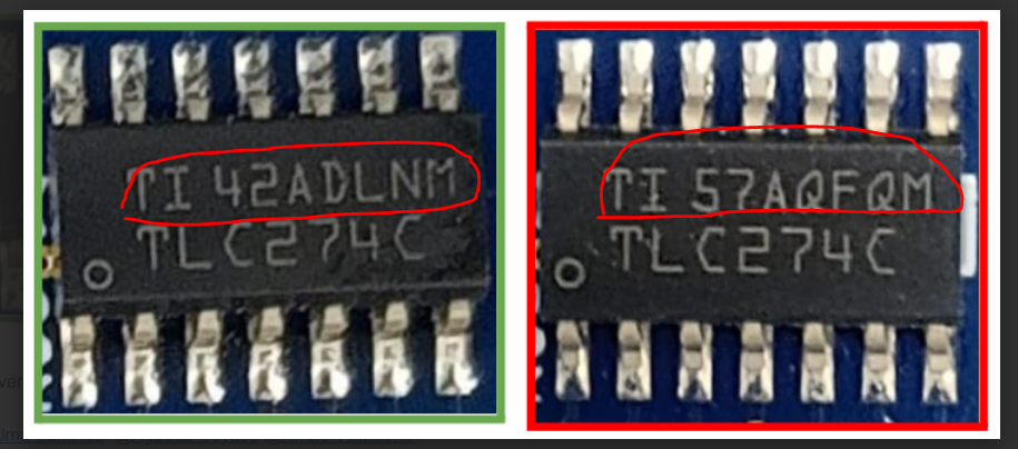

Hi team!
I have a question regarding the differences between the two following markings.
The TI datasheet only references the "TLC274C" marking. Could you please clarify the distinction between these two?
  • Footnote (6) says:
    There may be an additional marking, which relates to the logo, the lot trace code information, or the environmental category of the part.
  • Hello Alondra,
    The 42ADLNM and 57AQFQM are the date and lot codes. These will change lot-to-lot.
    The first two numbers/letters are the date code - the last digit of the year, and the month 1 (January) to C (December).
    "42" = 2024 Feb
    "57" = 2025 July
    The the last 4 characters are a partial lot code, and the last letter identifies the assembly site. With this information we can trace the lot.
