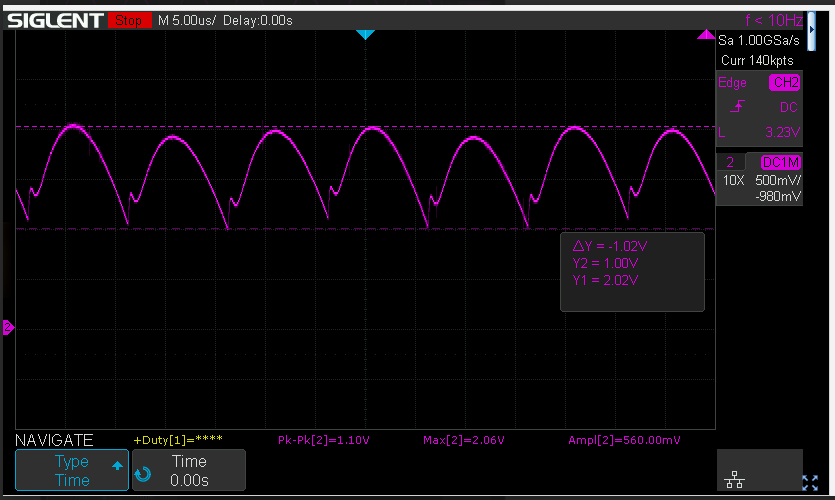

Hi, im using OPA2810IDGKR as differential current sense amplifier in my sawtooth wave generation design.
I have attached the circuit of the same. Here the U11 opamp power is changed from 3.3V to 15V.
While doing the current measurement during testing, i have found Phantom Current on the output of the differential amplifier opamp U11 which is given below.
Here the green waveform represents the current passing through the load which is a coil of 220uH inductance and 50 ohms DC resistance connected across P1 and P2 measured using current probe.
The red waveform represents the output of U11A. To reduce the Phantom Current, i have changed the resistors R51 & R54 to 100E and R50 & R55 to 10K with 1% tolerance and i got good improvements which is given below.

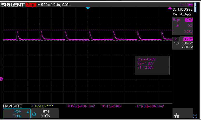

The phantom current is still present in the output of U11A and it is reflecting during no load condition also. I have captured the output in no load condition below.
Could you please suggest how I can completely eliminate the phantom current from the output of the differential amplifier U11A.

    The circuit is essentially a sawtooth wave generator. By default, the waveform is continuously generated and then amplified to the required level of 20Vpp using the U12 op-amp, as shown below.
    When an inductive load is connected across the P1 and P2 terminals, I can observe the expected current flow, as shown in the attached waveform.
    Therefore, irrespective of whether a load is connected or not, the sawtooth waveform is always present. The current-sense differential amplifier feedback path is used to measure the current through the inductive load and adjust the sawtooth voltage whenever the current crosses the defined threshold.
    The issue I am facing is that, in both loaded and no-load conditions, I am observing a phantom current during the falling edge of the sawtooth waveform. I would like to completely eliminate this behavior.
    I hope this clarifies the basic operation of the circuit. Please feel free to reach out if any additional details are required.

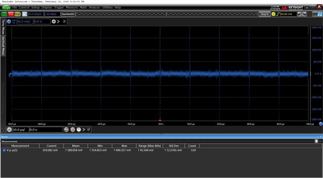

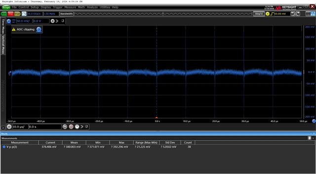

  • Hi Ignacio.
    Please find the waveform taken across sense resistor (ICOIL_IN+ and ICOIL_IN-) without load given below.
    Please find the waveform taken across sense resistor (ICOIL_IN+ and ICOIL_IN-) with load given below.

    Thank you for sharing these. It does make sense that you are seeing this across the sense resistor. With this same condition I assume you are seeing the pink signals from your original post at the output of the difference amplifier. You did add that you later increased the supplies to the OPA2810 from 3.3V to 15V. This is the correct step as 3.3V is below the minimum recommended supply for this device. However, the reference buffer (LMV611) you are using has a max supply of 5.5V and from your schematic, you are sharing the same supply with the OPA2810. Could we confirm if this is the case? I am trying to focus on the difference amplifier now that we know the input signal should be ~0V from your screenshots.

    Sorry for the misunderstanding on my side in that case this is not an issue. I was looking at the screenshot of ICOIL_IN+ and ICOIL_IN- and it does look like there is some kind of spike at 10us and is repeated. Is this accurate, if so, this should result in some output at the difference amplifier.
    Ignacio
  • Hi Ignacio,
    Yes the spikes in the input at 10us intervals are causing the spikes at the output also. So, could you please suggest some solutions or workarounds that can be implemented to suppress those spikes without affecting the main input signals. The main input will be in the semi parabolic shapes reapeating at 10us intervals without spikes.
