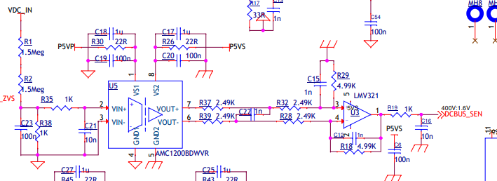

1.We are facing a issue while using this configuration actually when we apply 565V DC at VDC_IN we are getting 0.1782 across R38, But as per calculation it should be 0.188 now we are getting almost 3percent less. I checked by removing R35 that time we are getting almost correct value.
2. when the VDC_IN zero the voltage across C22 we are getting 150mV but at the 6th and 7th pin of U5 is zero. Here we are using U3 TS321AILT . Finally at the out put of U3 is 600mV.
the output of U3 is going to ADC pin of microcontroller. to measure DC bus
