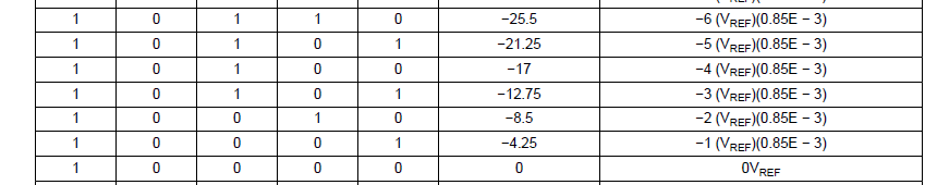

I think there's an error in table 6-10 contained in the PGA309 user's guide (SBOU24C)
The code 10101 appear twice in this table.
Can you confirm this issue?

Hi Frederic,
Yes, I believe the correct bit code for -12.75mV offset is 10011 based on +12.75mV code.
Bit code 10101 is for -21.25mV.
