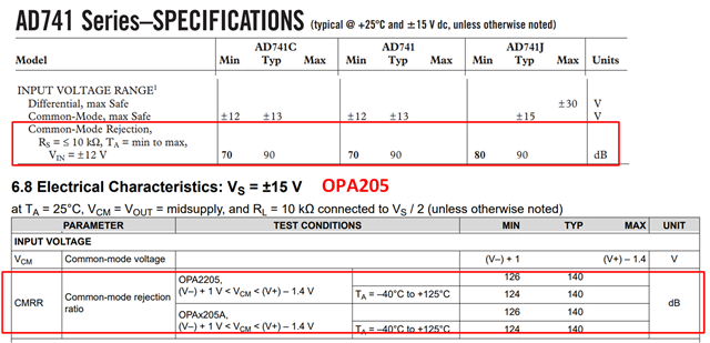

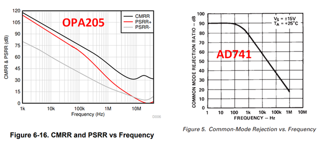

Hi, help in comparing the OPA205A with the AD741SH. I am good with most of the comparison but when I get to comparing the CMRR of the AD741 (Fig 5 on datasheet) with the various CMRR tables on the OPA205 datasheet I get lost. How does the OPA205A stack up against the AD741SH on CMRR vs Frequency?
