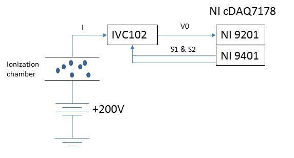

  • Hello Bruce,
    Well, actually I inspected the S1 and S2 timing signals accurately before starting my measurements. S2 is generated with a National Instruments DAQ system, i.e. NI cDAQ1778 with digital module NI9401. A counter is set-up to create a pulse train 10us low and 9990us high. I have inspected the signal with a scope, but I cannot identify a difference between alternate pulses generated by the counter.
    Above you can find a schematic of my set-up. I have used a prototyping electronics board to deploy the IVC102.
    Regards, Pieter
  • Pieter,
    Your block diagram helps but a detailed schematic might be more revealing.
    I assume that you have connected the internal capacitors for a total of 100pF integrating capacitance. Correct? So an integrated output of 1V for 10ms relates to a 100nA input current. You show the NI 9401 controlling both S1 and S2. I assume that the S1 control signal is a continuous logic high, correct?
    It appears that you are measuring the output voltage with the NI 9201. Are you confident of the timing of this measurement? Perhaps time delays in the measurement are causing the sampling to occur at different times. Have you looked at the integrator waveform with an oscilloscope? Do alternate integration ramps end at different voltages as observed on the oscilloscope? If the integrator waveforms appear the same on alternate cycles then there must be a timing problem in the sampling of the voltage. An integration followed by a hold period prior to reset allows for more variability or "grace period" in the measurement timing.
    Next step in trouble shooting, I suggest that you eliminate the chamber as a possible cause. Create an independent source of test current to the input--a 10M-ohm resistor connected to a 1V voltage source. This should provide a reliable 100nA current to test the circuit. Do you get the same result?
    Regards, Bruce.

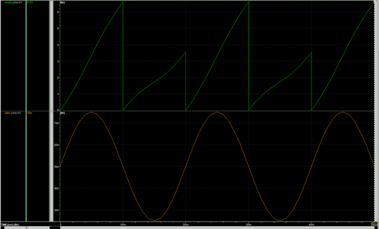

    We have updated our prototyping board with the IVC102 to a more properly designed board and ionization chamber, but still observed the same phenomenon. However, with help of some of my colleagues, we managed to isolate the problem with help of a current source, as you suggested in your earlier post, and eventually solve it.
    we had a strong pick-up of 50Hz background signal.
    Just getting back to your additional questions:
    • All internal capacitors have been connected for a total of 100pF
    • S1 is a logic high and S2 is as described in Figure 1 of the IVC102 data sheet.
    • The circuit we have implemented initially is an exact copy of Figure 1 in your data sheet, with a 10ms integration time as mentioned above.
    My colleague, Alvaro Geraldes, simulated this circuit with SPICE, adding a 50Hz noise source at the input with an amplitude of 75nA.
    This is exactly what we have been observing all along.
    Subsequently, we started looking for the actual source of this noise:
    • We have verified that is was not originating from our current source.
    • We have upped the value of the bypass capacitors for the power supply to reduce any possible 50Hz noise. This did not change anything, so the 0.1uF appeared to be sufficient
    • In the end, the ion detector plate appeared to be the source of pick-up noise. Properly shielding this with a grounded cage solved our problem.
