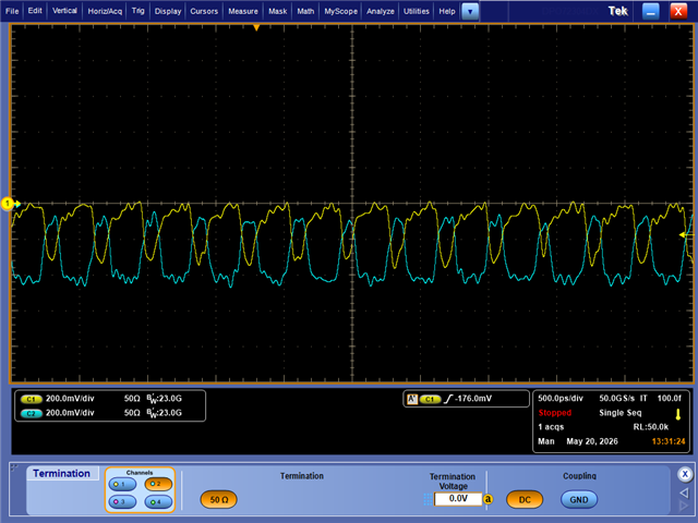

We are currently evaluating your comparator and observing some unexpected output behavior. We would appreciate your support in understanding the issue.
In our design:
  • VCCI = 5.2 V
  • VCCO = 3.3 V
  • VEE = Ground
  • Hysteresis pin is connected to ground through a 750 Ω resistor (as per datasheet, expected hysteresis ~20 mV to 30 mV)
  • LE pin is connected to ground through a 470 Ω resistor.
  • LE/ pin is left unconnected
  • VTP and VTN pins are left open.
Observed behavior:
  • Case 1: VP ≈ 0 mV, VN ≈ 50 mV
    Output: QP ≈ 3.17 V, QN ≈ 3.13 V
  • Case 2: VP ≈ 91 mV, VN ≈ 106 mV
    Output: QP ≈ 3.19 V, QN ≈ 3.11 V
Ideally, we expect a clear differential output as mentioned in the datasheet, but both outputs are nearly at the same level.

    How are these nodes being probed? Are you able to share some oscilloscope waveforms or schematics? How do the outputs look if you increase the input differential?
  • The current measurements are for DC Levels. We are validating first the static performance of chip. There is no need for waveforms, even in the scope it is straight lines. Once we get the static measurement proper then we will moving towards dynamic performance of chip. The data we have given is very detailed and self explanatory.

    Thank you for your patience. I've personally gone ahead and conducted some experiments with the TLV3901 in the lab.
    For the following tests, I connected the TLV3901 with the following operating conditions:
    VCCI = 5.2V
    VCCO = 3.3V
    VEE = VTP = VTN = VN = GND
    HYS = 750Ω to VEE
    LE_N = Floating
    LE = 2.9V
    VP = Swept by DC power supply
    There is no external termination at the outputs of Q and Q_N.
    I began sweeping the VP voltage with the DC power supply, and probed both VP. Q, and Q_N with a digital multimeter. Below is the table of my DC readings.
    VP Q Q_N
    98.9mV 3.285V 2.528V
    49.1mV 3.285V 2.528V
    9.2mV 2.930V 2.875V
    Using the same configuration, I connected the outputs Q (Channel 2) and Q_N (Channel 1) to a 500MHz BW oscilloscope. I swept the VP from 50mV to GND, and I obtained the following scope shot as the outputs transitioned:
    For the next test, I connected the outputs Q (Channel 2) and Q_N (Channel 1) to a 26GHz BW oscilloscope. This time, there is an external 50Ω to VCCO from the oscilloscope (high speed scopes do not allow for high impedance inputs). Please also note that the 0 level on the waveform is VCCO. Once again, I swept VP from 50mV to GND until the waveforms collapsed from a clean CML differential:
    As you can see, there is significant chattering at the output between VCCO and VCCO - 400mV, and it's not stuck at some mid-CML level.
    What is most likely happening in your DC tests is that you don't have a clean differential between VN and VP. Noise from your VN/VP drivers as well as interference from your environment are causing the VN and VP channels to cross and exceed the configured hysteresis. This causes the output to chatter at a very high frequency.
    The mid-CML level you are reading in your DC test is due to the low-pass filtering effect from the bandwidth of your test equipment, and you are reading an average voltage in both Q and Q_N that level out at around 3.15V.
    As you can see in the first two tests, the chattering is wholly undetectable by the DMM and the 500MHz BW scope; they both interpret the outputs to be some DC mid-CML voltage when in reality the outputs are toggling at a very fast rate.
    To mitigate this chattering, you can increase the hysteresis of the TLV3901 by shorting HYS to VEE or alternatively clean up your VP and VN signals.
