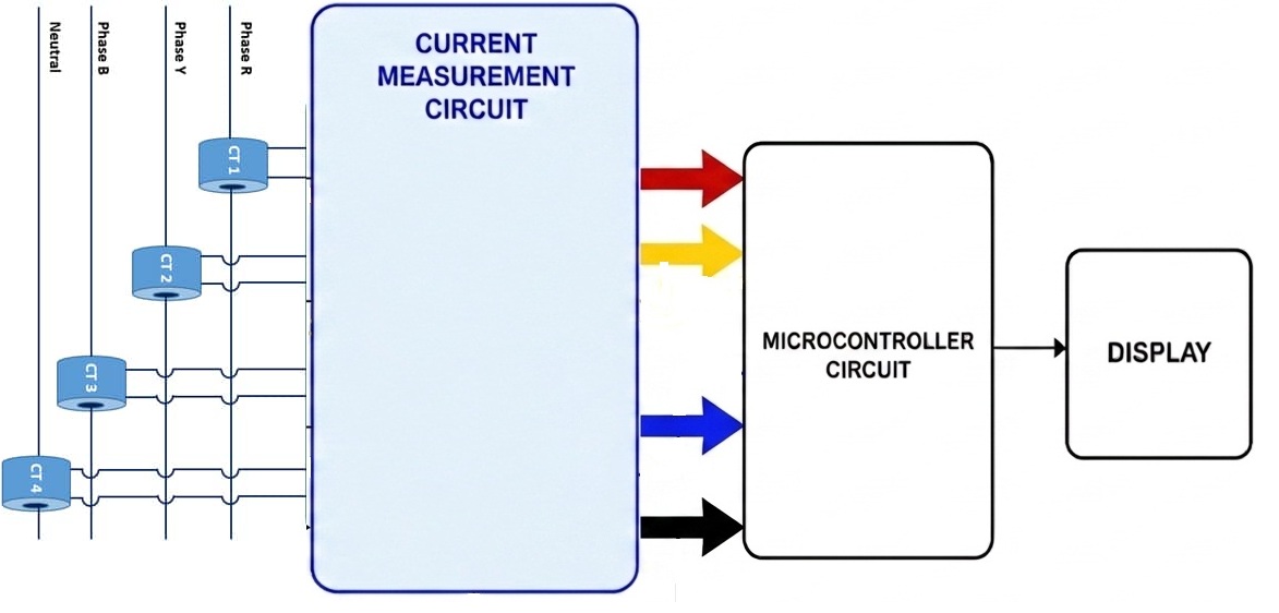

We need to interface a CT with a microcontroller for current measurement. The required measurement range is 0.01 A to 60 A with a 10 mA resolution.
Please find the attached block diagram for better understanding. We require the reference circuit for the blue highlighted section.
Awaiting your response soon.
Thank you in advance.

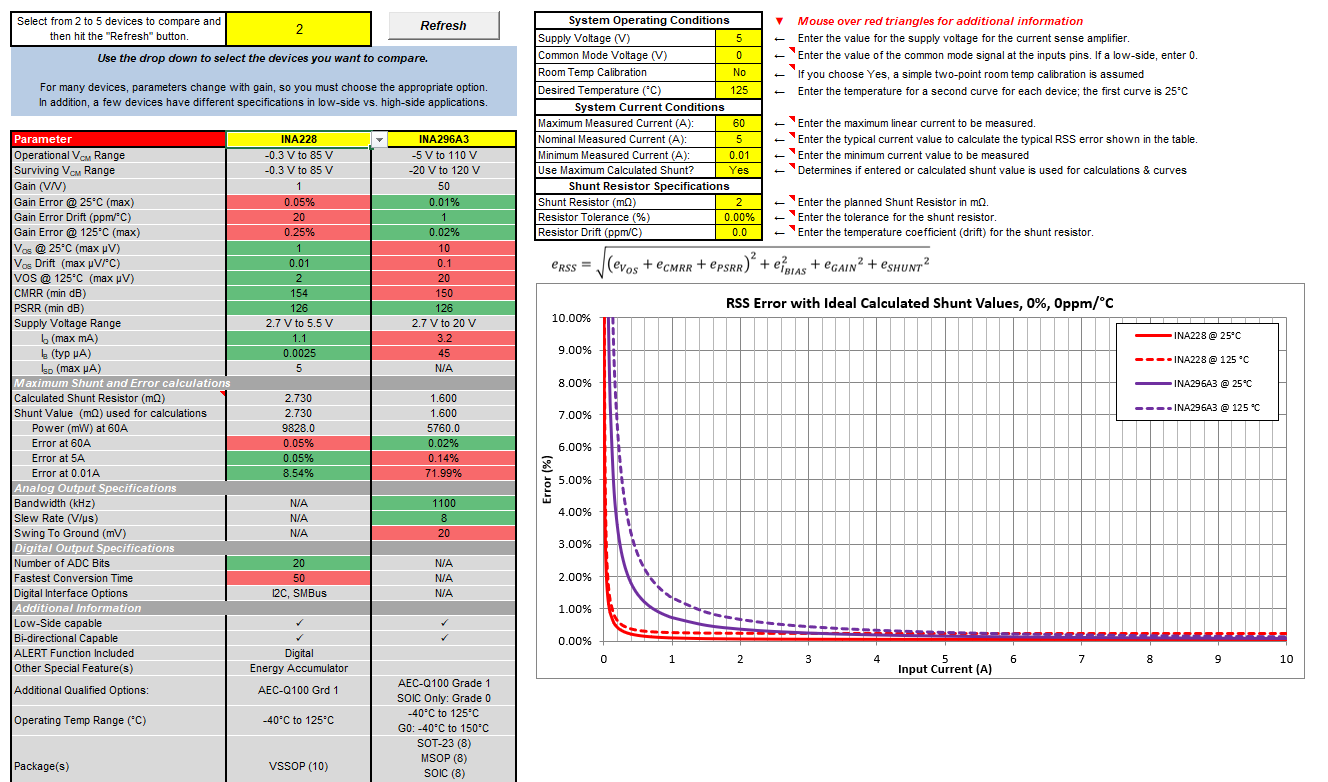

    I have a concern here though in your dynamic range. To size the shunt appropriately for 60A, you limit the amount of sense voltage that your lower boundary (10mA) is going to generate, and therefore offset error dominates. Check out the below analysis on both INA199 and INA296:
    As you can see from the above, in both cases, the lower measurement is effectively destroyed by the offset voltage. You would almost certainly need to calibrate. Is that an option for the solution?

    As I mentioned previously, this is going to be a very hard spec to hit based on a single device. ~4 decades of current measurement is not an easy problem to solve. Check out this application report on the challenges you will face as you design this. From an analog standpoint, with regard to offset and GAIN error, the INA296 I presented up above is the most accurate part that we offer, and as I show below, the error at the lower end is likely unacceptable (72% error). You could also look at this from our digital devices perspective with the INA228, which would greatly simplify the problem, and only possesses 10% error at the 10mA mark:
     However, there is still a problem here in that to achieve the above solution, you now need to find a 2.73mΩ resistor capable of standing up to ~10W of heat dissipation at the maximum condition of 60A before taking resistor derating into account. Other solutions I could recommend would be:
    - potentially investigating multiple devices for each leg to break up the range you are attempting to measure. With this approach you can optimize each device for the portion of the range it is measuring.
    - Implement a switching scheme such as shown in this reference design to break up the range of the device.
