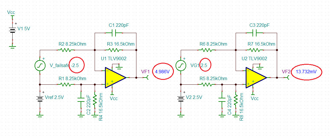

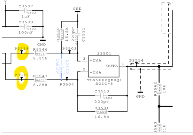

Hi team,
My customer is using TLV9002 to converter differential output of AMC0311D-Q1 to single ended output . TLV9002-Q1 is using single rail power supply. When high voltage supply lost AMC0311D-Q1 will output negative voltage (Vfailsafe), we'd like to check the behavior and output of TLV9002 under this scenario. Looking forward to your reply. Thanks
