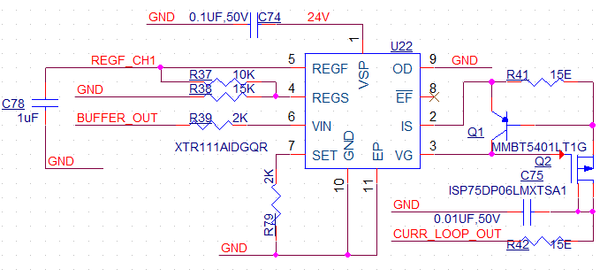

We are using XTR111 in a simple 4-20mA current loop application, with an extra loop protection using TPS26614 at its output. However, we have seen the XTR111 fail on multiple cards, and give out a limit current of 33-34mA even when there is no fault present at the output.
The circuit is shown here. The input voltage is in the range of 0-4V DC.
Can you please support us to resolve this?

    The sch of the output is as shown below, it has a TPS26614 protection followed by TVS. Input comes from a voltage follower OPAMP stage.

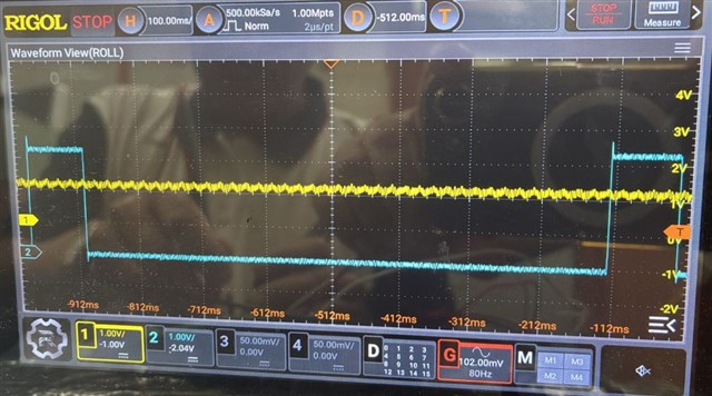

    The waveform of XTR111 input (Pin 6 - Yellow) and TPS26614 output (Pin 5 - Blue) is shown below. Input in this case is a 80Hz, 200mV peak to peak signal with DC offset of 1.2V, output is terminated using a 100 ohm load. What we see at the output is a limiting current of ~33mA (3.3V). Pulsating is seen due to the TPS26614 auto-retry function.

    Could you please show what is connected to the other side of "BUFFER_OUT"?
    For a 4-20mA application, I would expect to see a scaling input as such:

  • Hello Carolina,
    Please see the input circuit below. The 4-20mA sensor input is sensed over a 200 Ohm res.

  • Hello Gaurav,
    Am I correct in assuming the voltage at PIN 3 of the OPA2197 is 0.8V (4mA) to 4V (20mA), as seen in the image below?
