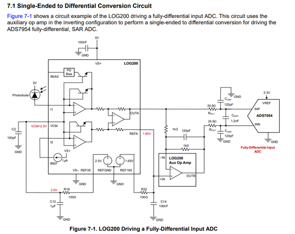

  • Hi Ishiwata-san,
    Thank you for bringing this to our attention. The circuit diagram you were referencing for your design was Figure 1-1 in the App note and has an error in the diagram:
    Perform Accurate Optical Current Sense Measurements Using the LOG200 Logarithmic Amplifier
    While we are in process of updating this document, please refer to Figure 7-1 for the correct configuration of the feedback capacitor. I have also attached a TINA simulation to help show the differences in behavior.

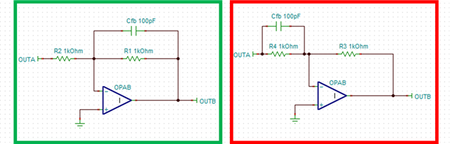

    To help visualize the difference, I have added the image below. Figure 1-1 Aux Amp is the red box and creates additional capacitance on the input that can cause stability issues. To limit the bandwidth of the aux amp, the feedback capacitor needs to be in parallel with the feedback resistor.
    For more information on why this input capacitance causes stability issues, please see this TI Precision Labs video: http://ti.com/video/6341904813112
    For any boards that have the instable implementation, the following solutions can be implemented:
    1. Depopulate the feedback capacitor - this should improve the stability of the op amp.
    2. If a bandwidth limited capacitor is needed, a re-work of the board is required. Temporary solution to see if the capacitor is needed is to stack the capacitor on top of the feedback resistor so they are parallel to each other.
