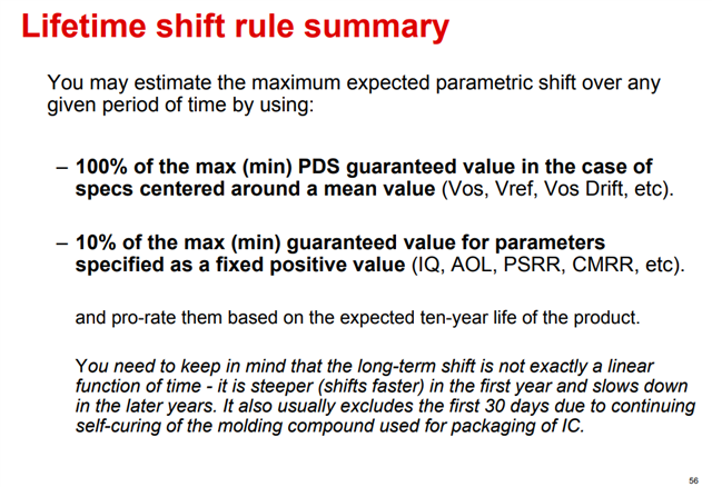

I am looking for long-term parametric drift data or HTOL (High-Temperature Operating Life) reports for the LMC6082 OpAmp.
Specifically, I need information on:
  1. Input Bias Current (IB) & Input Offset Current (IOS) lifetime drift
  2. Input Offset Voltage (VOS) long-term drift
  3. Channel-to-channel tracking: How well do the two channels within the same package match regarding VOS drift over time?
  4.  Open-Loop Gain (AOL) stability under long-term aging.
Any official reliability summaries or aging curves for the LMC608x family would be highly appreciated.
Thanks in advance!
Christopher

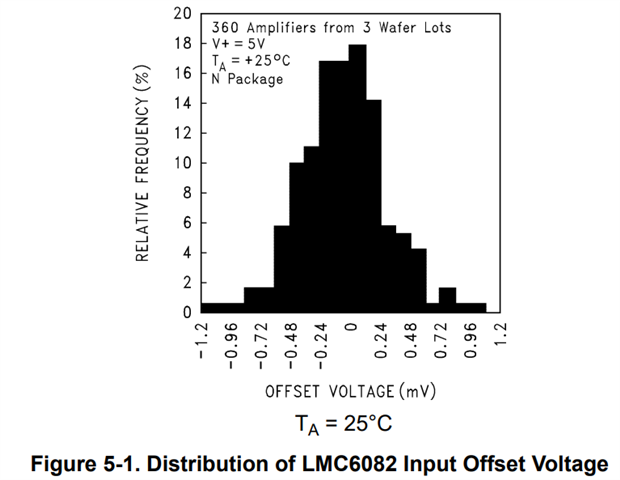

  • Hi Christopher,
    I apologize, but I'm unable to disclose that information.
    Although we do have long term drift plots for some of our devices (such as zero-drift amplifiers), the LMC6082 is not a device we have this data for. You can estimate the lifetime drift for 0 centered specs with a gaussian distribution (such as Vos and IB) using the distributions provided in the datasheet.
    You can find the full details on how to calculate long term drift specifications in this slide deck here. There is also a video associated with it, which can be found here.
    Let me know if you have further questions.
