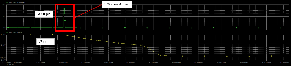

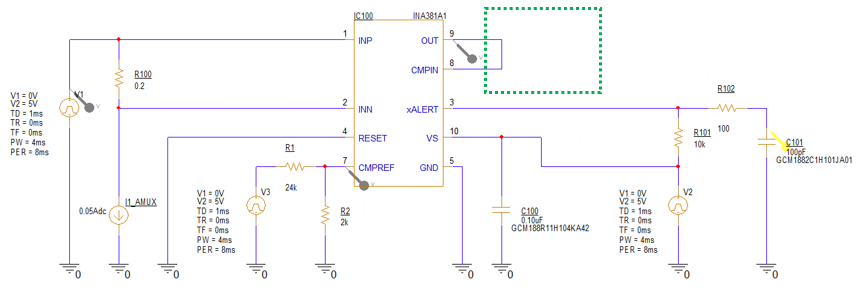

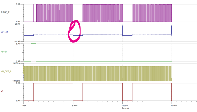

  3. My customer simulated the PSpice model of INA381A1-Q1. The voltage of VOUT pin becomes 17V at maximum when the power supply to VS+ pin is off. I have attached the simulated waveforms and the simulated circuit below.
4. The output voltage of VOUT pin exceeds the abs max of OUT pin which is 5.3V when power supply of VS+ pin is 5V. In this case, the voltage of VOUT pin gets clamped to 5V or the IC gets broken due to the violation of abs max of VOUT pin?

    I have confirmed with our design team that the output is internally clamped to avoid it going much higher than supply.
    Looking at the simulation, it really looks like it's an artifact of the simulation itself.
    Rerunning the simulation, we see the same spike...
    It appears to be coming about from the customer’s setting of “0ms” rise and fall time. There has to be some realistic value of rise and fall time, or else the system doesn’t know what to do. If we update this to even 1ns, the artifact disappears...
