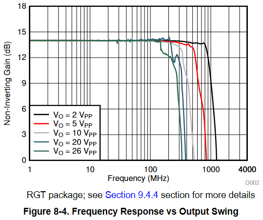

  Customer found the output can not reach 5.5V after input singnal beyond 300Mhz, only about 2V, is that true? but the simulation can reach 5.5V

    This is our highest performing large signal bandwidth device. Unfortunately, we currently do not have a device that can output 5.5Vpp at 600MHz. I am surprised it is dropping off the so much at 300MHz but it will likely not get you to 600MHz without some level of attenuation as its 3dB bandwidth is 550MHz at 5Vpp.

  • Yes, OP1dB of TRF37C75 is close to 19dBm (~5.6Vpp on 50Ω) so if linearity is also a concern, it needs to be backed off, and 3.5Vpp is about right where one will start to see the waveform distort.
    For TI options, I think we are back to THS3491.
    If source and load are both 50Ω, the amplifier will have to swing 11Vpp right at the output with a total load of 100Ω, to get 5.5Vpp at 50Ω load. They should be able to get about 300MHz, ~5.5Vpp into 50Ω with THS3491, maybe a bit more if inverting config used, but not 600MHz.
    Does the load have to be 50Ω or is 1MΩ termination that many scopes have ok, or some lighter load in between?
    If it has to be 50Ω load, they would need an RF amplifier (or PA, power amplifier) that supports 40MHz to >600MHz frequency with about 24-25dBm OP1dB, that TI currently does not have.
