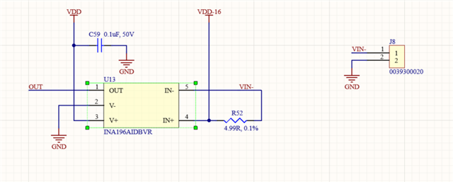

  • Hello Joe,
    Please find attached the schematic, PCB layout, and the folder containing the INA196 input and output waveforms for both conditions:
    • with the current module connected
    • without the current module connected
    Kindly review them and let us know your observations.

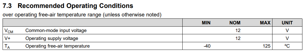

    Based on the results, the IN+ and IN- input waveforms are violating the 18V maximum analog input ABS max conditions of the INA196.
    This will cause device damage.
    When operating where the IN+ is above 20V and IN- is also 20V, the performance of the device is no longer valid and you can damage the INA196.
    Please correct your circuit to ensure that the recommended operating conditions are followed for the INA196.
    Depending on the load connected to J8 pins 1 and 2, can potentially try low side current sensing by changing the connections of your schematic like I am showing here:
    However, you may have damaged the device so I recommend replacing the unit with a new INA196.
    I hope this helps,
    Joe
  • Hello Joe
    please find attached updated schematic.
    can you please once review it and let me know if you have any suggestions.
  • Chetan,
    Thanks for your patience. Due to the U.S. holiday, we are currently out of the office. Joe will reply when we return starting 5/26.
  • Hello Chetan,
    Yes this is the proper way to implement low side current sensing.
    I would still encourage you to measure the voltage on each side of the shunt before soldering the INA196 onto the board.
    The recommended common mode voltage needs to be adhered to.
    I hope this helps,
    Joe
