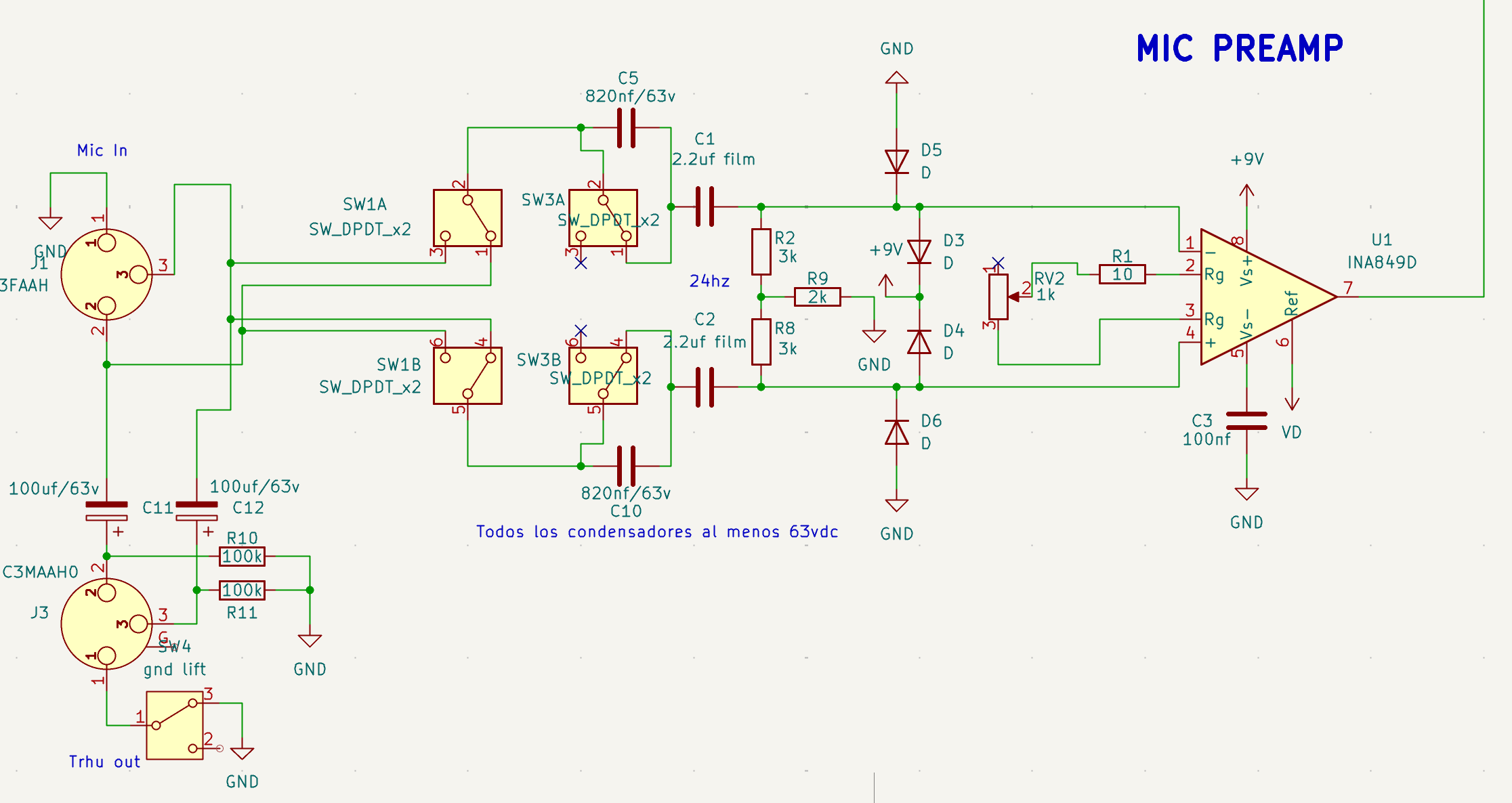

INA849: Analog potentiometer to control gain
Part Number: INA849
I'm designing a simple mircrophone preamp to use with dynamic microphones using this IC, following the datasheet schematic but I'm not sure about how to implement the control of the gain on Rg, and what kind of potentiometer would give me the best response. Could you help me with that?
