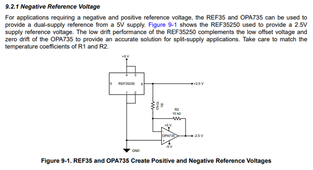

Are there any REF power supplies that have a
negative voltage output ?
No; all these series voltage references output a positive voltage, i.e., a voltage relative to the more negative supply rail.
Shunt voltage references (e.g., LM4060-Q1) can be used in both positive and negative applications, but are slightly harder to use.
I will second the above and also add this example from the REF35 datasheet showing how to generate a negative reference voltage:
Please let me know if there are any additional questions.
