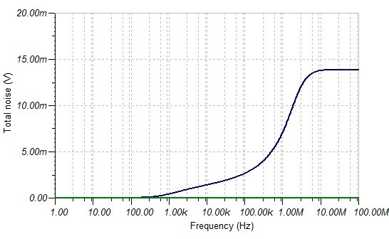

I have built a transimpedance amplifier using OPS355. I am generally happy with the performance but I like to check with the masters here, if the total noise performance is acceptable.
According to TINA simulation I should see a worst case noise of 15mV. Please see the attached.
However when I look at the system noise, I see about 50mV white noise on my system. I use a special probe with a short ground loop so I assume it is pretty reasonable measurement. The overall gain of the system is 6M times. I brought this noise figure down from 200mV level in my previous board so I assume it is decent but again I like to confirm with the experts.
The schematic is also attached.
