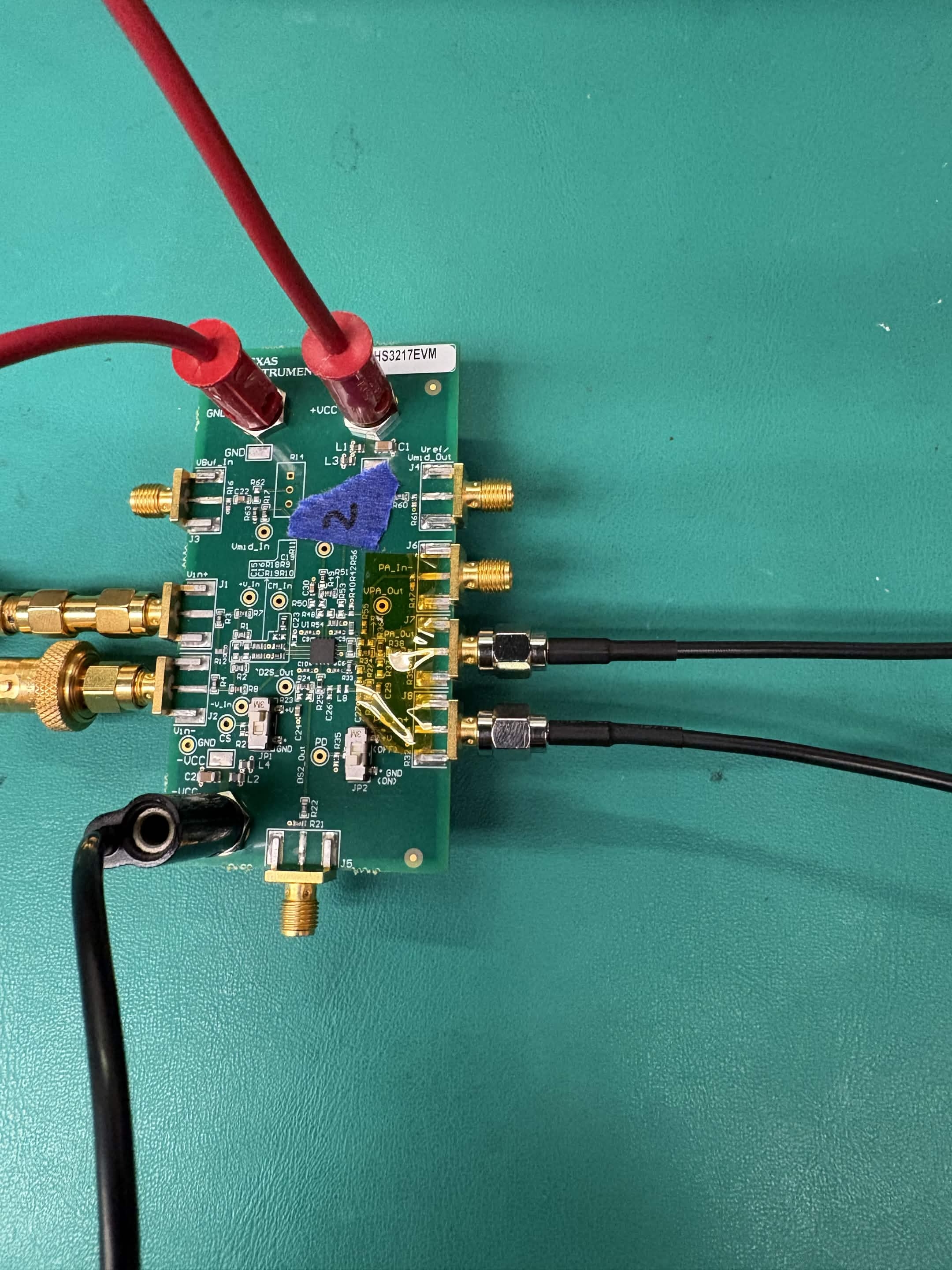

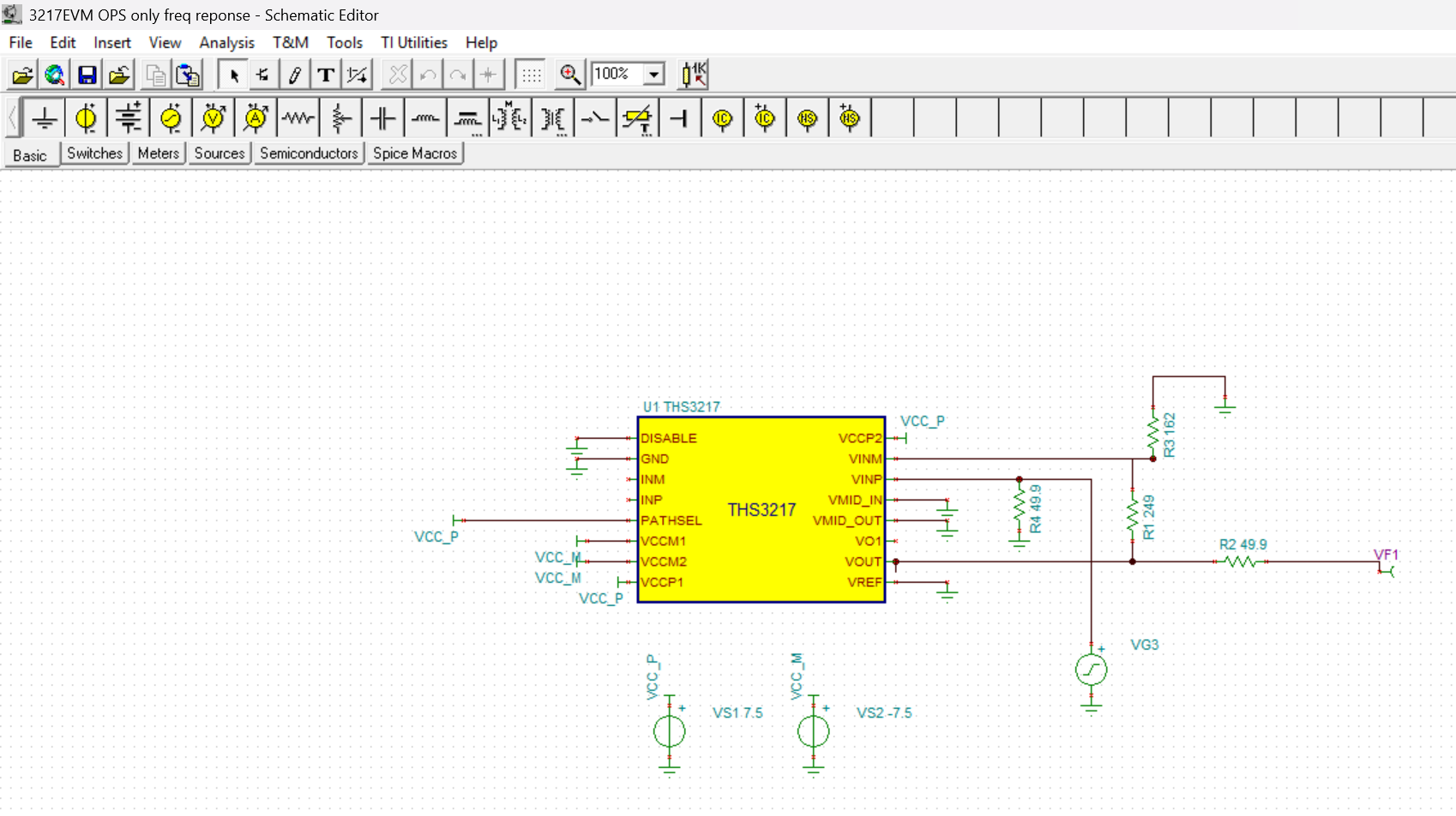

I am trying to cross verify the OPS stage for my THS3217 EVM.
I am using TINA TI for my simulations and a network analyzer for my THS3217EVM.

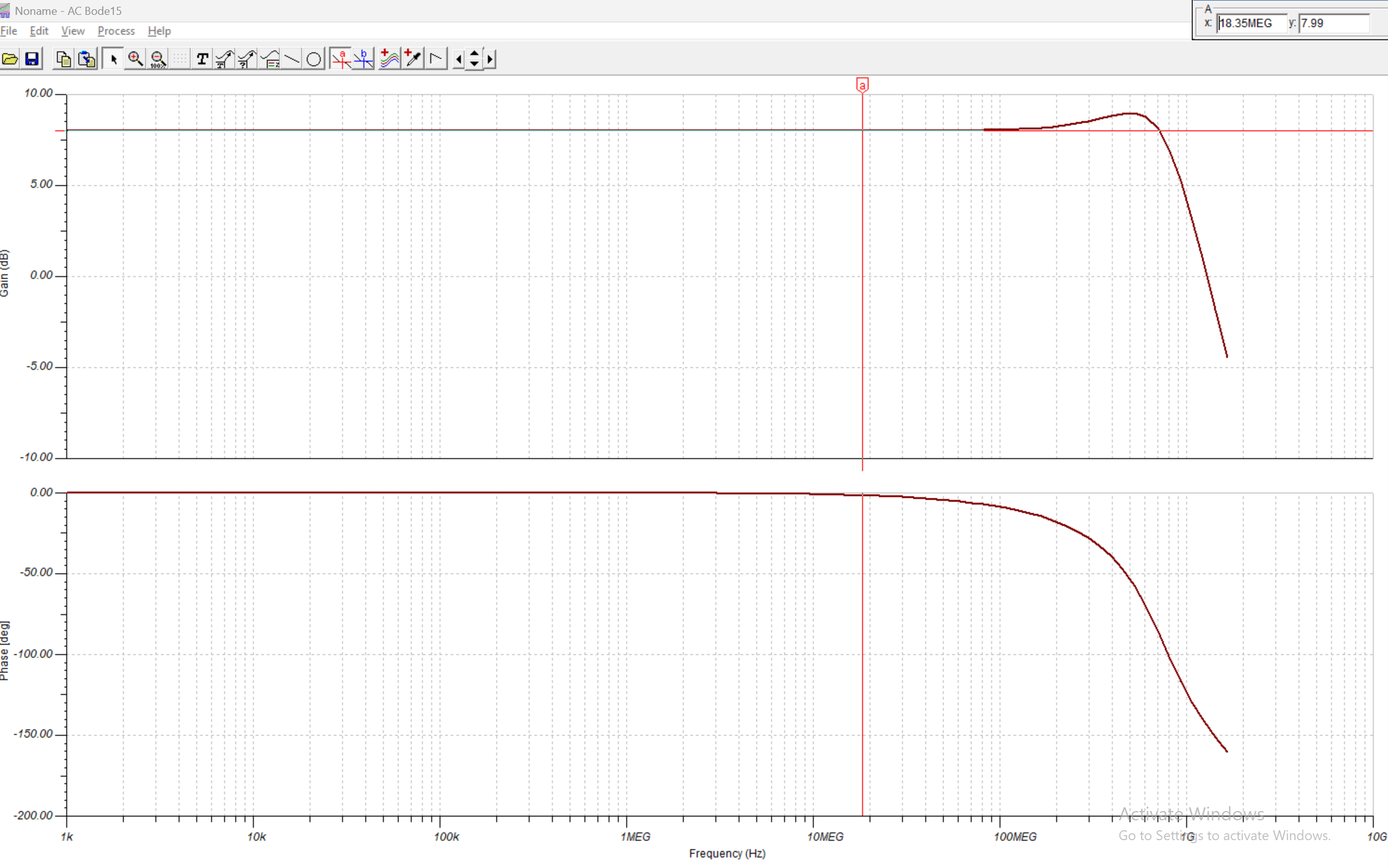

Below are my simulation results

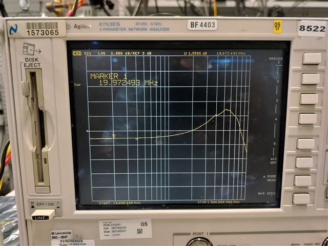

Here are my results from my network analyzer
*the two sma connectors on the left(Vin+ and Vin-) are not connected to anything.
My simulation results in 8dB gain, while I get 6dB gain on the actual circuit. Is this reasonable?
