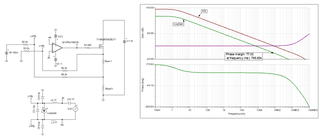

The attachment shows the function of Howland current source amplification. How to simulate loop stability in this form? Thank you!

Li,
The best method to test this circuit is described in Operational Amplifier Stability Theory and Compensation Methods section 3.3. Below is the test done on your circuit. The phase margin is 77deg, so the circuit is very stable. Even though the circuit is stable, I do recommend adding two feedback capacitors. The feedback capacitors help reduce noise and improve stability.
