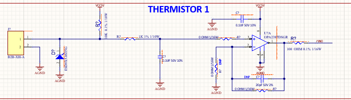

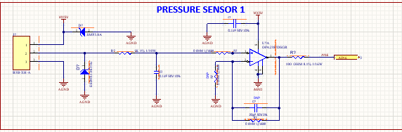

Hello TI team,
I have designed buffer circuit with OPA2387DSGR. Inputs arte pressure sensor (0-5V output) and thermistor. Buffer output is connected to ADC ADS114S08IPBSR (please refer follwoing link for more information) https://e2e.ti.com/support/data-converters-group/data-converters/f/data-converters-forum/1651315/ads114s08-schematic-review-of-ads114s08ipbsr-and-opa2387dsgr?tisearch=e2e-sitesearch&keymatch=%20user%3A617902#
I have attached the schematic images and pressure sensor data. Please review the design and let me know the changes if any required.
