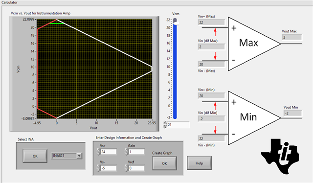

    You mentioned two different configurations. I'm going to run calculations on the first one but tell me if that's wrong.
    I still need to know a few things:
    1. What gain?
    2. What is your desired output voltage range?
    Using the Analog Engineer's Calculator, I assumed your gain was 1V/V, as well as using the first set of conditions you described. This can easily be changed but it's the starting point I'm going on for right now.
    Now looking at the input common mode range that you mentioned (0V to 21V) I wanted to look at the two extremes.
    At Vcm = 0V, the output voltage range is -4.85V and 6V.
    Moving the Vcm = 21V, we can now see that the output voltage is more limited than before at ±2V.
