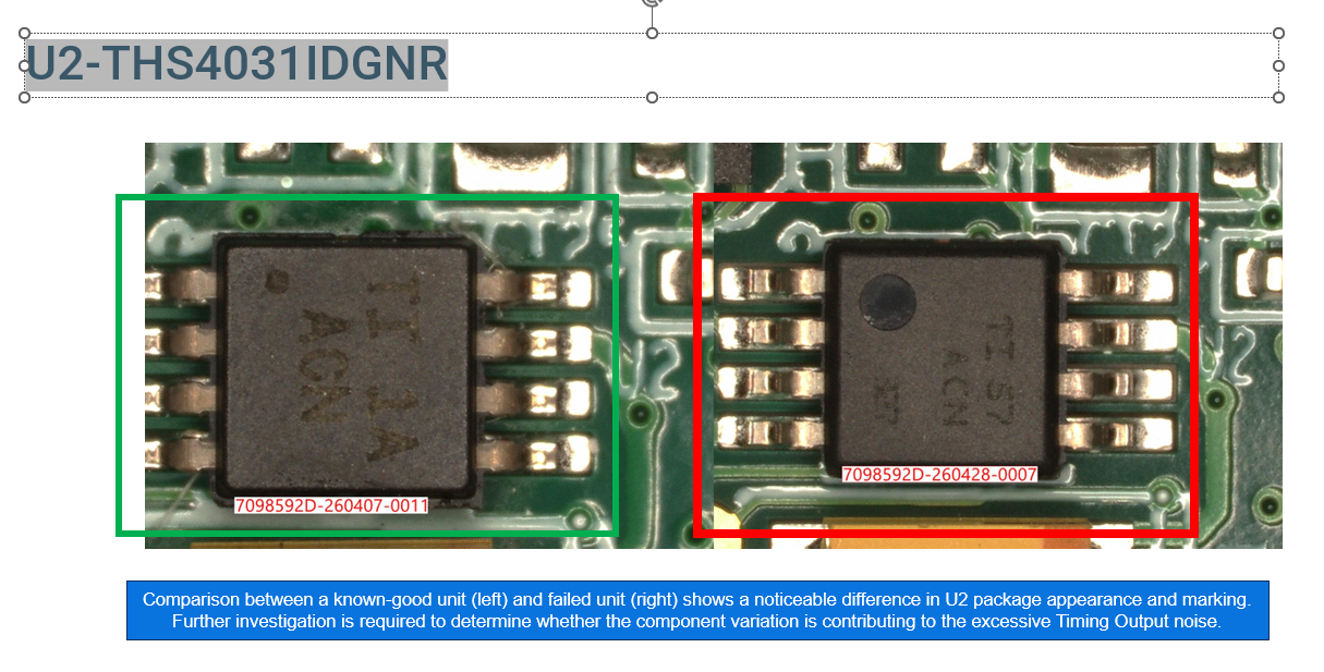

We are seeing a variance in noise performance of  THS4031IDGNR physically marked:
first line "TI 57"
second line "ACN"
not legible but I believe third line is "327"
These parts are failing at almost 100%; they were sourced from Arrow. I'm attaching the fab site qual PCN; did TI re-spec the noise performance?

  • Hi Ignacio,
    I will forward the information to you as it becomes available to me. Is it possible to purchase parts from your 150mm Dallas fab? We have discovered the noise is not present when using these parts.

  • Hi Dan,
    Unfortunately, this will likely not be possible. We have both old and new stock that are equally likely to get delivered to customers so it is hard to confirm exactly what we can source and send. However, I am happy to look over the circuit and offer suggestions to improve the behavior.

  • Hi Ignacio,
    Thank you for the lead. We will investigate, and I will reply back here. One additional question: is there a specific marking on the package that denotes the parts came from the Dallas fab? We are trying to source parts, and as of right now the only way I know how to do this is to sort by date code* (pre-March 2024 per the PCN).
    Thank you
  • Hi Dan,
    I was able to ask our team and they believe this would likely be the best way to tell which device it is. The issue is that under certain circumstances depending on where the die is being assembled you could get the same markings potentially if they packaged old and new die so I am not sure if seeing the markings is enough to tell in my opinion. I would potentially consider using the date code like you suggested and looking at the markings as a second option/check. If I receive an update on what other markings or package labels can be considered I will let you know.
