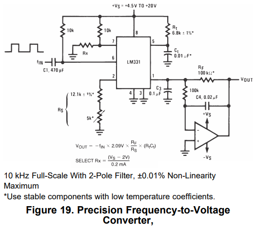

Dear Forum,
In a production tester I use LM331s to measure RPMs with a new encoder 360 inc/rev.
(Max RPM is 9000 FS to be measured). Previously I used 100 inc/rev encoder without any problem.
For new encoder Rt-Ct was scaled down: Ct=4n7 -> 1n5 while Rt=12K (Rout=18K || 330nF, Rs~15K trimmerable, VCC=5V, loading is by LMC6482 non-inverting amp x4 to produce standard 0-10V automatic signal).
Now, -with new encoder- when tester calibarted say at 4000 PRM, the 7000 RPM measured inaccurately (too low value by ~300).
Note, there are two '331 in my system, one is quite OK (~still acceptable, error is only 100 PRM) but the second one exhibits unacceptable error mentioned above) despite the circuits exactly the same (ICs are soldered onto the PCB so I could not swap them).
It was tried using signal generator instead of encoders but the result is the same.
Can the '331 handle such high frequencies as F/V (~50KHz)? It seems something extra delay/prop. time starts to be effective at higher frequencies. Or the problem caused by an improperly choosen Rt+Ct pair?
Can you pls give some advise?
Joseph
  • Hi Joseph,
    Are you using this implementation from the datasheet or a different circuit?
    Yes, the LM331 should be able to handle up to 100kHz frequencies; however, the device is only specified to 10kHz, so non-linearities and errors may be introduced at the 50kHz range.
    Ashley
  • Dear Ashley,
    Thank you for your quick response. Partially: output filtering is different: 3rd order Sallen-Key Bessel fc~20Hz formed by two opamps  Everything else is the same. However, Rx =10K at pin 7 in my circuit. Maybe is to too low value: the differentiated trigger pulse may not have enough amplitude to overdrive the input trigger comparator (tpd higer->can degrade perfomance)? I change RX to 56K at least.
    Joseph

  • Hi Ashley,
    thank you for the advise. I could fix the problem, now the RPM measurement in the full range within 1% accuracy. Thre were two problem:
    - Rx pull down at Pin#7 was equal to pull up (10K) - > bias voltage was very low, much lower than bias at Pin#6. - > Should be the same. I now use 68K ensuring near same bias at both comparator terminal.
    This solved the problem partially:
    - Altough for new encoder CtRt product was decreased by the Ct lowering but not enough. For new ecoder (higher frequency) new ideal value is 1,3nF but I used standard 1,5nF causing problems again at top of the range -> Rt also lowered 12K->8,2K, CtRt < Tmin*0,75 required.
    I think you can close this thread.
