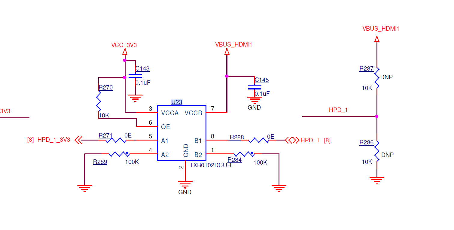

Hi Team,
We are using the TXB0102DCUR IC as a 5 V to 3.3 V level translator. In our design, R286 is populated with a 100 k pull-down resistor, while R288 is DNP.
The measured voltage levels while connecting the HDMI cable are as follows:
Condition Before HPD_1_3V3 Net HPD_1_3V3 Net R288 Connector Side
Without HDMI cable 1.6 V 0 V 0 V
With HDMI cable 1.6 V 0 V 4.2 V
After populating R288 with a 0E resistor, the measured voltages were:
Condition Before HPD_1_3V3 Net HPD_1_3V3 Net R288 IC Side
Finally, after lifting pin 5 of the TXB0102DCUR IC, the voltage levels changed as follows:
Without HDMI cable 0 V 0 V 0 V
With HDMI cable 0 V 0 V 4.2 V
From these observations, it appears that pin 5 of the TXB0102DCUR IC is causing the issue on the HPD_1_3V3 net. Could you please help us identify the root cause and suggest a solution to resolve this issue? The schematics of the following section is attached below.

    In this device, we are validating the HDMI interface. We are using a TXB0102DCUR level translator to convert VBUS (5V) to 3.3V before connecting it to a 4:8 MUX. The issue we are facing is that the level translator fails to provide the 3.3V output when the HDMI cable is connected.

  • Section 7.3.2 of the TXB0102 datasheet says:
    For proper operation, the device driving the data I/Os of the TXB0102 must have drive strength of at least ±2 mA.
    The 10 kΩ resistors are too weak.
    Section 7.3.5 says:
    The output drivers of the TXB0102 have low DC drive strength. If pullup or pulldown resistors are connected externally to the data I/Os, their values must be kept higher than 50 kΩ to assure that they do not contend with the output drivers of the TXB0102.
    That 1.6 V shows that there is a pull-up/-down resistor that is too strong.
    The TXB0102 is not suitable for handling the HPD signal. Use a unidirectional translator like the TXU0101, which has a high-impedance input that works correctly with any pull-up/-down resistors, and a strong output that can drive any pull-up/-down resistors.
