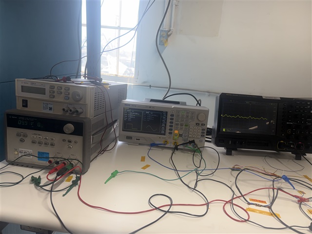

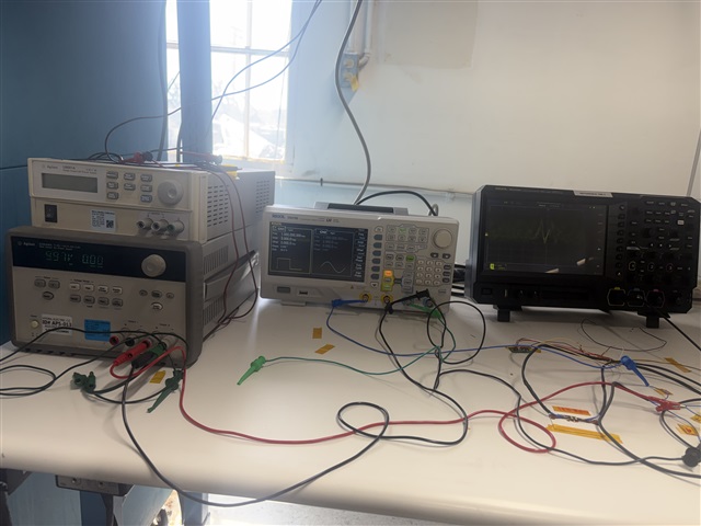

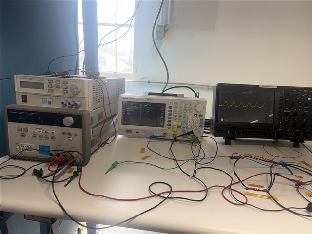

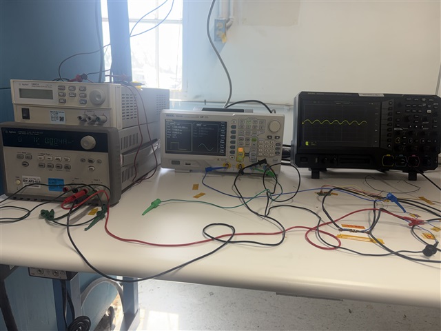

  • Hi Ignacio,
    I have attached for pictures of the setup and results. The test was supposed to be Slew Rate measurement. As you can see from the pictures, I have applied V+=10V and V-=-10V. The circuit is voltage buffer circuit. VIN+ is square wave (from Sig Gen) with amplitudes of 1Vpp, 2Vpp, 3Vpp, 4Vpp. The output was captured on the scope, which is shown in the picture. Let me know if you need more clarification. Thanks
  • Hi Nader,
    Thanks for sending this over. I believe the issue is coming from the fact that this is not done on a PCB from what I can see. In order to get this low of offset measurements using proper PCBs with proper termination makes a huge difference. The issue you could be seeing with the slew rate test is that the long cables are distorting your signals or maybe even reflecting. I would recommend using a proper PCB to collect data on this device as you will likely continue running into issues.
    Ignacio
  • Hi Ignacio,
    As I mentioned above, all parameters are bad (VOS, slew rate, swing, everything). Not only slew rate. The slew rate is shown as just a sample. I dont think the issue is with ceramic substate. my OPA2333SHKJ is on ceramic substate and tested under same setup and it works fine. I think the part just went bad. Reliability is important for our application. Any suggestion what went wrong ? Can we send the parts to TI for failure analysis ? AD has AD8634 (flat package), which can withstand 210C, but it is more expensive than TI counterpart. Unit price was the reason we selected TI part . But, we are not willing to compromise reliability and sturdiness with cost. Thanks

  • Hi Nader,
    The device appears to be unstable within your current test configuration, which is likely caused by parasitic capacitance from the long output cables. This capacitance can destabilize the op-amp, leading to the increased Iq you are observing.
    To demonstrate this, I have included an example below using an extreme case. Note that when the device is unstable, both the Iq and the output voltage show unexpected results. However, by adding a 100 Ω isolation resistor between the output and the cable, the oscillation is eliminated.
    The 11mA Iq measurement you are seeing is likely the average value captured by your DC meter during oscillation. To confirm this is the root cause, please try shortening the output cables or adding a series isolation resistor to decouple the output from the cable's parasitic capacitance.
    Chris Featherstone
  • Good Morning Chris,
    Sure. Let me try that. Thanks.
  • Hi Chris,
    I connected a 105 Ohms resistor to the output. Measured. Same exact results. The same output waveform, the same output value ( -0.250 V), the same IQ= ~12.5 mA. I think the unit is out of its characteristic parameters.
  • My output waveform is noisy and hazy, is not clean oscillation as you showed in the diagram in your prior post.
  • Hi Nader,
    To help us narrow down the root cause, could you please clarify a few points regarding the test environment?
    • ESD Protection: Is it possible the device was exposed to an ESD event? Additionally, what ESD controls are currently in place for this test setup?
    • Test Methodology: Have you had the opportunity to test the device on a custom PCB with the component soldered?
    Looking at the image provided, the device appears to be mounted to a glass fixture using long wires. This setup introduces significant risks for external errors regarding stability and EMC (Electromagnetic Compatibility) interference, which can be difficult to rule out. We typically recommend a soldered PCB configuration to ensure we are measuring the device's true performance rather than fixture-induced errors.
    Chris Featherstone
  • Hi Chris,
    My OPA211-HT is glued to a white ceramic substrate. There is no external components soldered to this part. I am measuring in the buffer configuration.
    I wear ESD wrist band, while testing, but I cannot rule out ESD damage.
    Most probable cause, though, may be the frequent exposure of the part to the 200C environment. Is this part characterized for a limited time exposure to 200C ? If exposure must be limited, then we should reconsider using this part in our application.
    As I said before, my other op amp (OPA2333-HT) was used in the exact same setup and the measurements came out all good, only VOS of CH1 is a little off of the datasheet.
