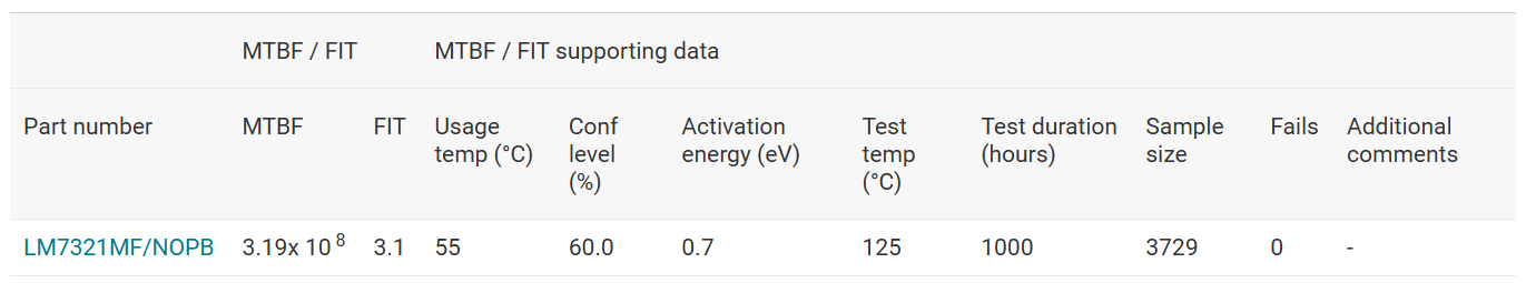

Part Number: LM7321
Hi Team,
Customer needs 90% confidence data, but we only have 60%, could you please help provide? Thanks in advance.

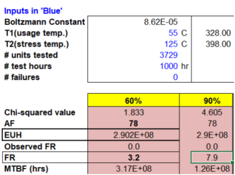

Francis,
Adjusting the confidence to 90% sets the FIT rate to 7.9.
