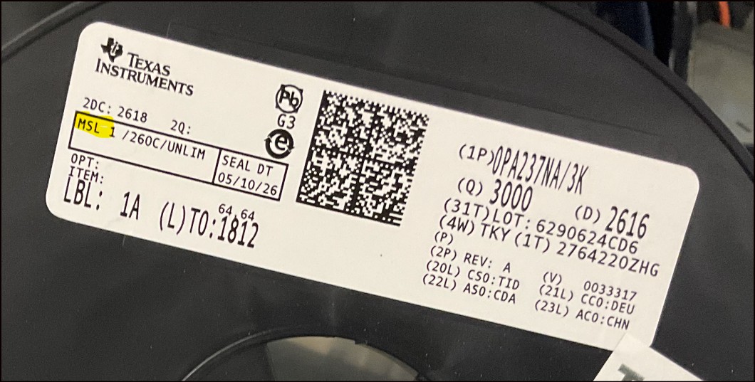

Customer has purchased part: OPA237NA/3K and claims received in ESD package. Our TI Label also says MSL1, but datasheet says the part is MSL 2. Please confirm.
The MSL rating on the datasheet reflects the "worst case" MSL rating for the device. Please have the customer use the MSL rating on the specific reel, as this reflects the MSL rating for that particular lot.
