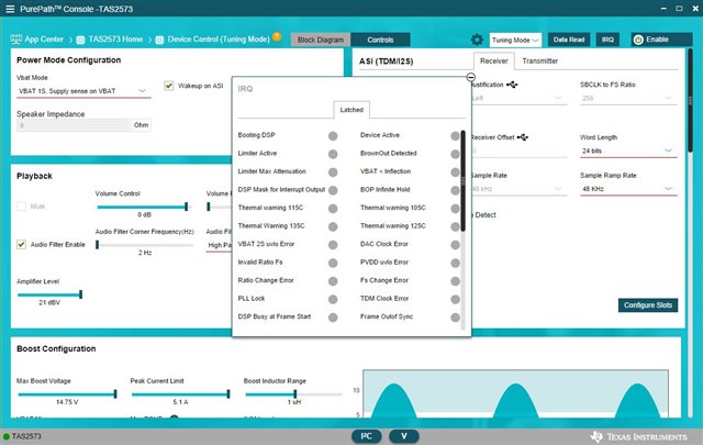

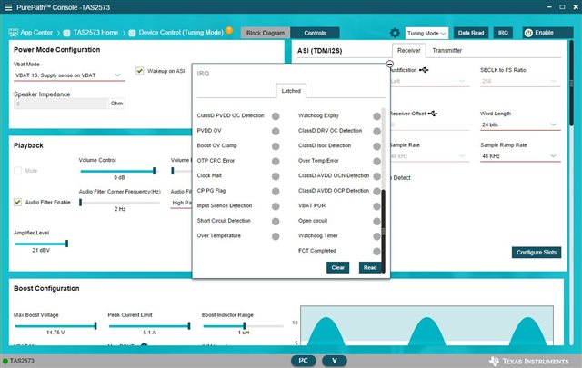

  • Hi  Wenbin:
        1.  Based on your advice,I am check with the IRQ as the below picture,please tell me if they are ok?
    IRQ1  IRQ2 IRQ3
    2.Based on your advice,I get the register dump,as the below picture:
    page0  page1
    I check the register value and find the PPC3 is different with the SPEC,please help to check if it cause they are no sound.
    page 0:  5F-- PPC3 value is 0a, the sepc value is 1a;
    Page 1: A---PPC3 value is ac,  the spec value is 98;
                19---PPC3 value is 03,  the spec value is 23;
                29---PPC3 value is 04,  the spec value is 64;
                64---PPC3 value is 71,  the spec value is 00

  • and meantime, the INT status seems not valid.
    please click the read button at the bottom of the IRQ page.

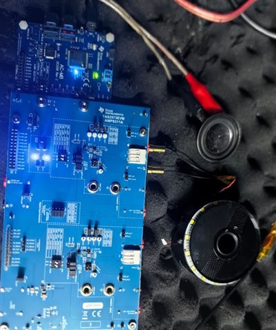

  • Hi Wenbin:
         I am checking the EVM board and find the left tas2573 amplifer unit(u1) and 3.3V LDO(U3) both are damged.so we can't run correct the PPC3(as the red line shows in the below picture)
    EVM damged loction
  • Our expert will feedback you shortly.
  • Hi Zhanshan,
    in this case, is it possible to use U2(tas2573) to do some test? if not, maybe you need a new EVM board.

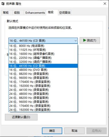

        I have received the new TAS2573 EVM,but I find the next question:
     1. the HW recailbration fail,shows the sample rate check is 44100Hz and 2 channel.but my pc only support one channel,if it can upate to 1 channel to check it ok

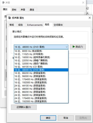

  • Hi Wenbin:
        I am check the ACMB setup same as the PC setup for the sample rate,but the PPC3 HW check still fail(as below picture),so I think it is TI EVM setup to the 2 channels cause it.please help to change it to one channel
    pc setup1  pc setup0 ti HW CHECK
  • Hi Zhanshi,
    please check both 44.1k/48k, 16/32 bit in both settings in PC side and TI-usb-audio.  usually it should use 32bit/8channel in ti-audio setting. and 32bit/48k(44.1k) in PC side.

  • Hi Wenbin:
    FXCN: Based on your request,I have check it,still fail the sample rate "2 channel 16bit 44100Hz" in PC setup.

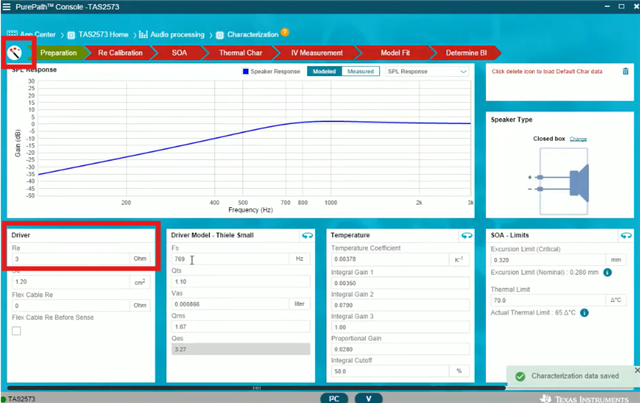

  • Hi Zhou,
    The new version of PPC3 is still not released pending some further updates.
    In the meantime, there is a workaround for lower Re speakers, please try with the procedure described below and let me know if you have any questions:
    • Visit “Tuning and Audio Processing” panel once
    • Go back to “Home” panel, and then go to “Device Control”
    • Make sure “Music Efficiency” module is disabled
    • Go back to “Home” panel, then go to “Tuning and Audio Processing”
    • Go to “Characterization”, before starting the process, click on the first circle icon on the top ribbon and edit the default Re value to something lower than the speaker being used, eg. 3-Ohm.
    • Then click on the same icon of the top ribbon and proceed with the characterization.
    -Ivan Salazar
    Applications Engineer
  • Hi Ivan Salazar:
        Based on your supplying steps to verify to change the Re to 3.6 ohm,the speaker sound is not becomed lower.But I have changed the Re to 3.6 ohm and save it to a PPC3 file,then I reopen the PPC3 page and download the PPC3 file with I save to update the Re to 3.6 ohm and find the sound still become lower.
    1:I compared the the Re calibration data and find the Re is 3.6 ohm based your supplying steps and online changed,but the Re is 5.08ohm based on open the saving ppc3 file with changing the Re to 3.6 ohm(as the below picture).why cause the different?
    A).updated online with your supply steps Re calibration value is 3.6 ohm based changed the Re from 6.04 to 3.6 ohm.
    online updated the PPC3
    B).reopen the PPC3 file and Re calibration the Re value is 5.07 ohm based your supplying steps(the 3.6 ohm is saved in the ppc3 file and no rechanged)
    download from the PPC3 file
    2. Based on your steps to change the Re value to 3.6 ohm,the speaker sound  does't become lower,but the Themical and IV calibration still root the PPC3 page.Please help to check with them.
