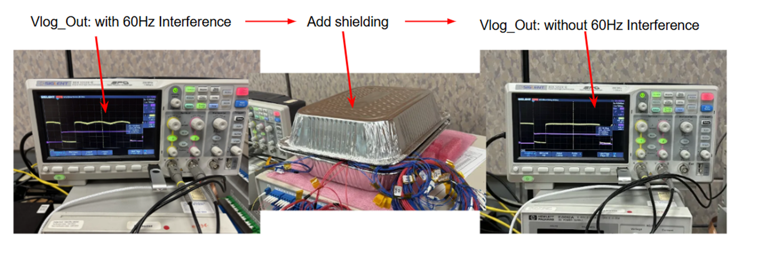

As shown in the figure below, the LOG200 Vlog_out signal exhibits 60Hz interference;
adding shielding helps mitigate this issue.
Is the TI LOG200 IC itself particularly susceptible
to external environmental interference at the PD input
(with the effect becoming more pronounced at lower currents)?
I ask this because I did not encounter this problem when previously using the ADI ADL5304.
  • Hi Alex,
    Yes, the LOG200 is susceptible to 60Hz noise. I am not sure why you are not seeing this with the ADL5304. Have you determined if this noise is coming from the power supply?
    How are you supplying the input current and what is the current range you are testing?
    Ashley

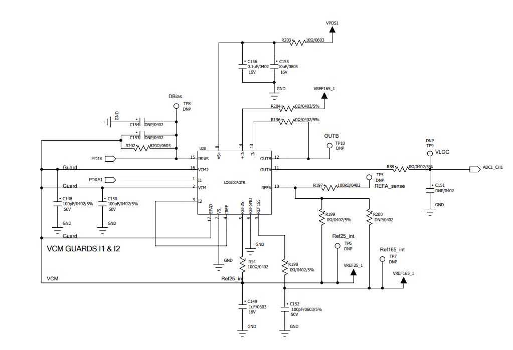

  • Hi Alex,
    Could you clarify your test image with the PSU? Is this the power supply voltage that is feeding into the LOG200? Can I also see how the LOG200 was connected inside the shielding? It's important to make sure the connections on the input and output are very short cables to minimize noise coupling.
    We tried switching to an isolated linear PSU,
    but the issue persisted.
    What "issue persisted" are you referring to? The 60Hz noise?
    The laptop charger has a high frequency switching noise that can couple to the board and cause higher noise. This would impact both devices.
    Do you have a comparison image of the ADL5304 output? Did you use the ADI EVM to test the output?
