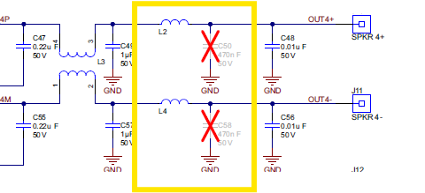

    1. Since we are using only two of the four available audio output channels (CH1 and CH2), we have provided the bulk electrolytic capacitors (560 uF) only on the PVDD pins associated with the CH1 and CH2 driver stage power supplies. Could you please confirm whether this implementation is correct as per our schematic?
    CH1 OUT - PVDD PINS - Pin 23 ,24
    CH2 OUT - PVDD PINS - Pin 32 ,33
    2. In the audio output stage, we have provided only a single LC filter (10uH+1uF as per the LC design calculator available from TI). However, in the TAS6684 EVM schematic, we can see that two LC filters are provided at the speaker output pins. Is the additional LC filter necessary for our design?
    We have attached a snippet of the EVM schematic below for reference.
    3. Is there any recommendation for not used OUT, BST pins, NC is ok?
    Adarsh.
  • Hi Adarsh,
    1.The implementation is correct.
    2.Since the PVDD is 8-36V. In order to pass EMI test, additional LC filter (1uH+220nF) is needed.
    3.NC is OK.
    Ethan
