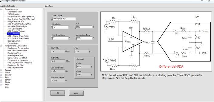

    3. I would recommend watching the video under SAR ADC front-end component selection at this link: https://www.ti.com/video/series/precision-labs/ti-precision-labs-analog-to-digital-converters-adcs.html, and using the analog calculator that we to calculate the necessary RC filter bucket for your settling time to be less than 1LSB. https://www.ti.com/tool/ANALOG-ENGINEER-CALC
    4. For example, in your case, you would need to meet a settling target of  1LSB --> (2.6V)/(2^14) = 159uV, 1/2 LSB --> 80uV. Once you have chosen your ADC, you can check the datasheet for your acquisition time and your capacitance sample and hold value to determine if the system can mathematically settle within the sampling window. Also note that an external RC network is mandatory between the amplifier and the ADC. The external capacitor acts as a local reservoir to absorb the current kickback when the ADC sampling switch closes, while the series resistor isolates the THS4551 to prevent capacitive loading, lowering phase margin which can cause ringing in the transients. In the video linked above, it will show how to use the calculator and then use Tina-TI or PSpice for TI to sweep the RC values and choose the values that will meet your 1/2LSB settling limit.
