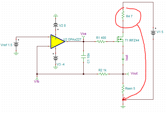

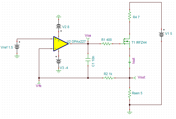

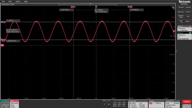

Hi TI expert
The attachment is the constant current source driver circuit for the OPA227. R4 is the load and is at high side. Now, due to a specific requirement, R4 needs to be connected to ground(low side). How should this constant current source circuit be modified to achieve this?
Best regards

  • Hi Art
    I hope you can help me design a Howland current source circuit. Vref is a tunable sine wave, with a minimum of 5MHz, preferably 10MHz.
    Best regards, Li

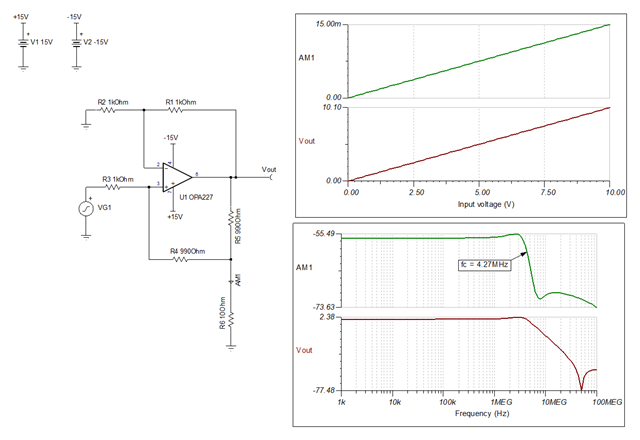

  • Li,
    Below is a Howland current source.  To further refine this design you need to let me know the output current transfer function Iout/Vin.

  • Hi Art
    The circuit in the attachment has a very small output current. I need the output current to be adjustable from 0 to 0.3A. The input sine wave signal can have a bandwidth up to 5MHz, which means the current signal through the load R6 can also go up to 5MHz. The load R6 is an LED, about 3~5Ω, you can start by simulating with 5Ω.
    Best regards, Li

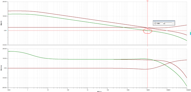

  • Hi Art
    Thank you for your reply!
    I still have a question now. I modified your simulation file for VG1, R4, and R5—see the attachment. The input signal for VG1 has been changed to a 1MHz sine wave. R4 was changed to 5Ω because it's used for current sensing. The simulation results show that at an input frequency of 1MHz, Iout < VG1/R5, and the current signal Iout is somewhat attenuated. If VG1's frequency is increased to 5MHz, how should the circuit be modified? Do we need to replace U1 and T1?

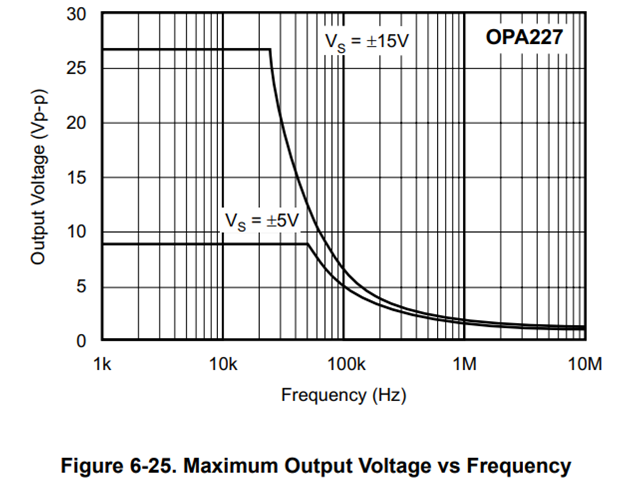

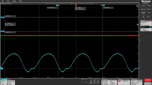

    1. I think that there are two issues:
      1. Slew rate limitation. The slew-rate of OPA277 is not high enough for the 1MHz sine wave.  This limitation is also know as full power bandwidth limit or maximum output voltage vs. frequency. Full Power Bandwidth and Op Amp Distortion covers this topic in detail.   Below is the curve for the OPA227.  You can see that at about 20kHz to 40kHz the output swing becomes limited.  You can substitute the OPA227 with an amplifier with higher slew rate.  I did this with OPA192 (similar to OPA227 for DC precision) and the sinusoidal output looks relatively undistorted, but the output is clamped at near zero output voltage.
      2. The circuit cannot swing to ground.  This is why the output is clamped near GND.  Note that the op amp output will try to push its output high enough to keep the transistor on, but it does not work when Vin is near zero.  I added a 100mV shift on the input signal and the output looks pretty good.  If you want to swing to  Vout = 0V, you will probably need a push pull output (i.e. NPN and PNP).  Hopefully you can accept a small shift in the input signal as this circuit will be much simpler.
    1108.holland-current-pump-with-power-transistor-opa192.TSC
    Best regards, Art
