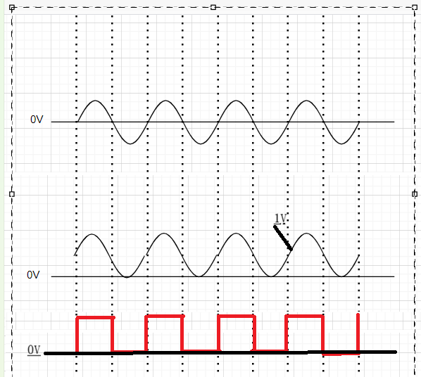

We have a project that requires a clock waveform conversion circuit, with the following specifications:
  • Input frequency: 100 MHz
  • Signal waveform: sine wave
  • Input level: 3 dBm to 5 dBm
  • Input DC offset: < ±50 mV
  • Output impedance: 50 R
Here's my initial approach:
  1. Since this is a 100 MHz clock and we need to preserve the higher-order harmonics, a high-speed op amp or comparator is required. I'm considering a device with a bandwidth greater than 1 GHz.
  2. The output needs to be a 3.3 V LVCMOS square wave to interface with a CPLD, so I plan to use a comparator to convert the sine wave into a square wave.
  3. From my calculations, 3 to 5 dBm into a 50 R coaxial cable gives a voltage swing of roughly 1.3 V.
  4. Because there may be a DC offset up to ±50 mV, I intend to use AC coupling to remove it.
My proposed implementation:
  1. At position 1 in the diagram, place a capacitor for AC coupling to strip off any DC offset.
  2. At position 2, apply a DC bias to eliminate the negative portion of the sine wave (please refer to the two sine waveforms in the drawing).
  3. At position 3, set a comparator threshold voltage using a resistive divider. However, since the input amplitude varies between 3 dBm and 5 dBm, a fixed threshold (I used 1 V) causes the output duty cycle to deviate from 50%.
Note: The intended behavior is that when the input voltage is above 1 V, the output goes high, and when it's below 1 V, the output goes low.
Could you please review this approach and let me know if it's feasible, or if there's a better solution you would recommend? If a comparator-based design is the way to go, what aspects could be optimized? Thank you.

    Try using a comparator; it is made for analog to digital output.
    TLV3901 is fastest.
    TLV3811 is fast at a lower cost.
    The DC bias is 1.65V, so using that voltage should keep 50%
