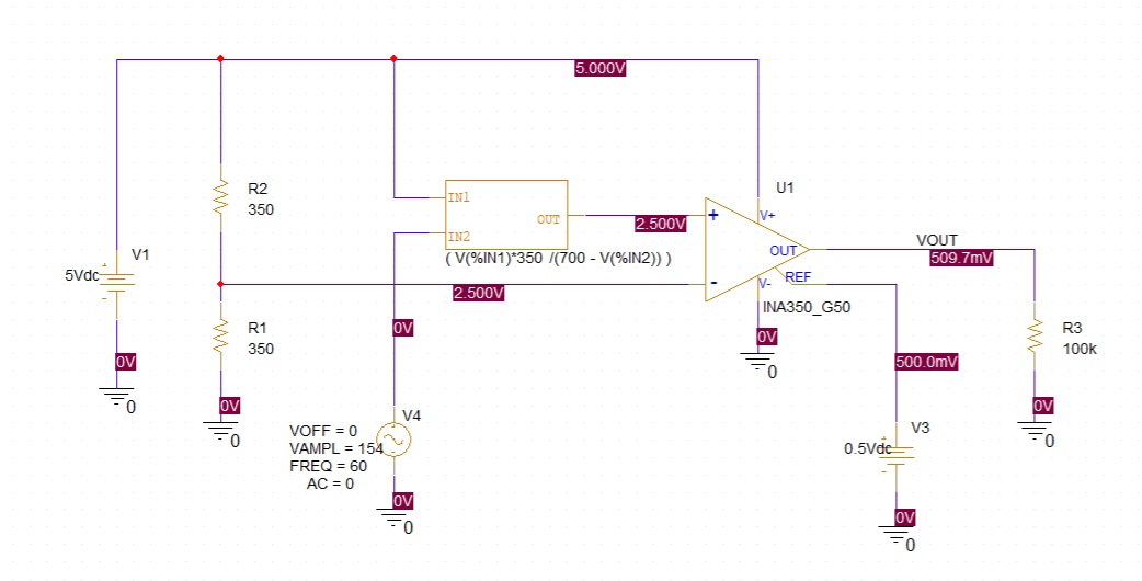

I am designing a circuit that converts load cell output
into an electrical signal using the INA350-D50.

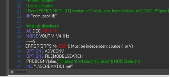

When I attempted to run a noise simulation in PSpice for TI,
the simulation was rejected because the signal source was
 not an "Independent Source."
Even after replacing it with an Independent Source
(specifically, a sine wave source), the error persists.
My simulation profile settings are as follows:
