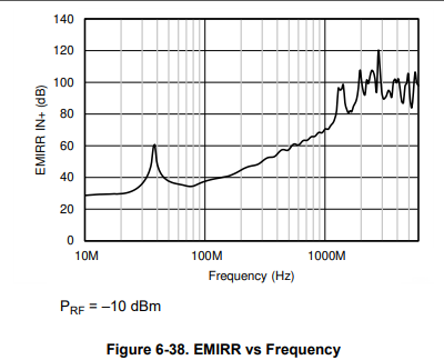

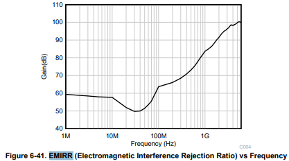

    Below I have created a comparison table showing the main differences between the devices. The green cells show what specs are better for each device.
    The best information I have for EMC is the plots for EMIRR below for the OPA2991 and OPA2145 respectively. The OPA2991 has a designed in EMI filter and for this reason it is better across frequency.
    The OPA2145 had a section within the product datasheet (7.3.7 EMI Rejection) on page 21.
    The OPA2991 has a unique slew boost architecture that is different from most other slew boosted parts. If you are operating under 20kHz you may consider the OPA2991. For more details on this I have written an application note that goes into a lot of detail on the OPA2991 slew boost. If this does not fit the need of your application then I would recommend the OPA2145.
