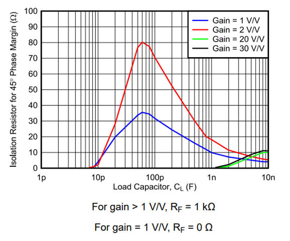

Looking for an alternate for the Analod Devices ADA4807-2, the Texas Instruments OPA2620 looks good but have a question about a capacitive load.  Is a unity gain buffer and a 10uF ceramic cap with no series resistor okay?  The data sheet discusses very lower capacitance values, 1nF needing a 10 ohm resistor.

    For the OPA2620, while it might work I think there will be a lot of gain peaking without a series resistor. It can often depend on the output impedance of the amplifier, and given how the Cload curve in the datasheet starts to flatten around 10ohms for 1nF+ I don't think it is recommended in this case without a lot of gain peaking.
    Some amplifiers can drive very heavy cap loads without a series resistor since that cap load basically becomes the new dominant pole. But for lower capacitive loads they still need an Riso since it interacts nearer to where the phase margin is an issue.
    What are your system requirements for bandwidth with that 10uF cap? There is probably a better part that could work.
    Evan
  • I was just looking a bit closer and the ADA4807 datasheet has a couple tricks in their cap load drive section. One is that Figure 68 is in a G=+2 and not unity gain, plus its series resistance is actually 0.5ohms for 100nF which can make a big difference. Figure 69 also mentions "at 3dB peaking" so it can depend on how much gain peaking you want.
