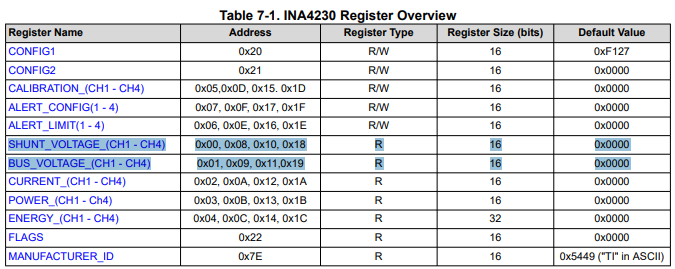

    The power total measurement error (PTME) is defined as sum of Bus voltage gain error (GBERR) and Shunt voltage gain error (GSERR), i.e. PTME = 0.75% + 0.75% = 1.5%, at full scale voltage (48V) and current.
    So the PTME is composed of two different errors, one from bus measurement and the other from shunt measurement. My earlier comment "you appear to be using 0.78V bus voltage, which is a very small fraction of the full bus voltage, this is probably where the bulk of your error is coming from" hypothesizes that most of the PTME error is coming from bus voltage measurement.
    You can check this by reading from the shunt_voltage and bus_voltage registers and calculating their individual errors to see which one dominates.

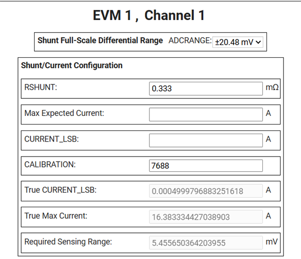

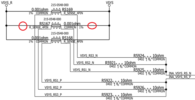

    we validated different power rail with VSYS (it is 20V) by DMM and INA. It has quite difference, and should be something wrong.
    DMM: 6.5W.
    INA: 27W.
    Below is design and setting. could you review again and give us suggestions, please, thanks.
  • Hi Zeer,
    1. What is the correct expected power measurement?
    2. Where did you probe using the DMM? Please probe the points circled in red.
    3. What is the max expected current you used for calculations? Was it ~16.3833A?
    Your schematic looks good, the filtering capacitor of 10uF is a little too large, perhaps a 0.1uF may be better, but this is not the likely cause for the error we're seeing.
    I'd like to check the layout as well, please share. One more thing to review in terms of layout, since you have 3 shunts in parallel, layout is critical to ensure that the current is split equally. Please see the following app note: https://www.ti.com/lit/an/sdaa115/sdaa115.pdf
    Mallika Senthil
  • hi mallika,
    1. we expect INA could be align with DMM in VSYS case, and is within 5%.
    3. max expected current ~16.5A with voltage=20V.
        Currently, the measurement power is ~6.85W in DMM.
        DMM measurement is ~ 0.113mV. 113/0.33mOhm~0.37A -> 0.37A*20V=6.85W.
    2. i'm not sure why can't attached picture here. i will attached measurement point and layout picture later, please, thanks.

  • hi mallika,
    the measurement point is here,
    below is layout.
    Please give your suggestions, thanks
    if possible, please share your email address, i could send picture, please, thanks.
    zeer

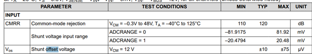

  • Hi Zeer,
    Thank you for your patience. Layout and schematic all look fine, where you're probing with the DMM is also fine, but I would check that the DMM has enough resolution to measure 113uV.
    Please provide a complete register readout, I want to check if the current and voltage measured by the device are correct. Power is calculated off these measurements, so next step is to check whether the issue is in the current or voltage measurement.
    Also, please note, you have set max current to 16.5A, but you are measuring 0.37A. This is a very small value in the range you've set. Also the device offset is ~75uV. So if your DMM is measuring 113uV, then the device's offset will add 75uV (max) to this and INA4230 will measure 188uV across shunt.
